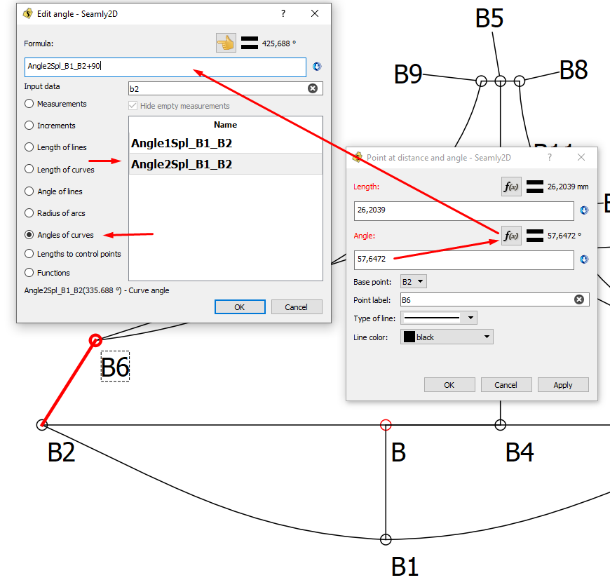

:slight_smile: A picture says it all :slight_smile:
Click on the Angle formula. Remove whatever you have in the formula box. Select Angle of Curves.
Find the curve that you want to use the direction of. In this case, your curve goes from B1 to B2, so the handle that you want to use is the 2nd handle, which is the one at B2.
Double-click it so that it copies it into the formula box and then add 90 degrees.
