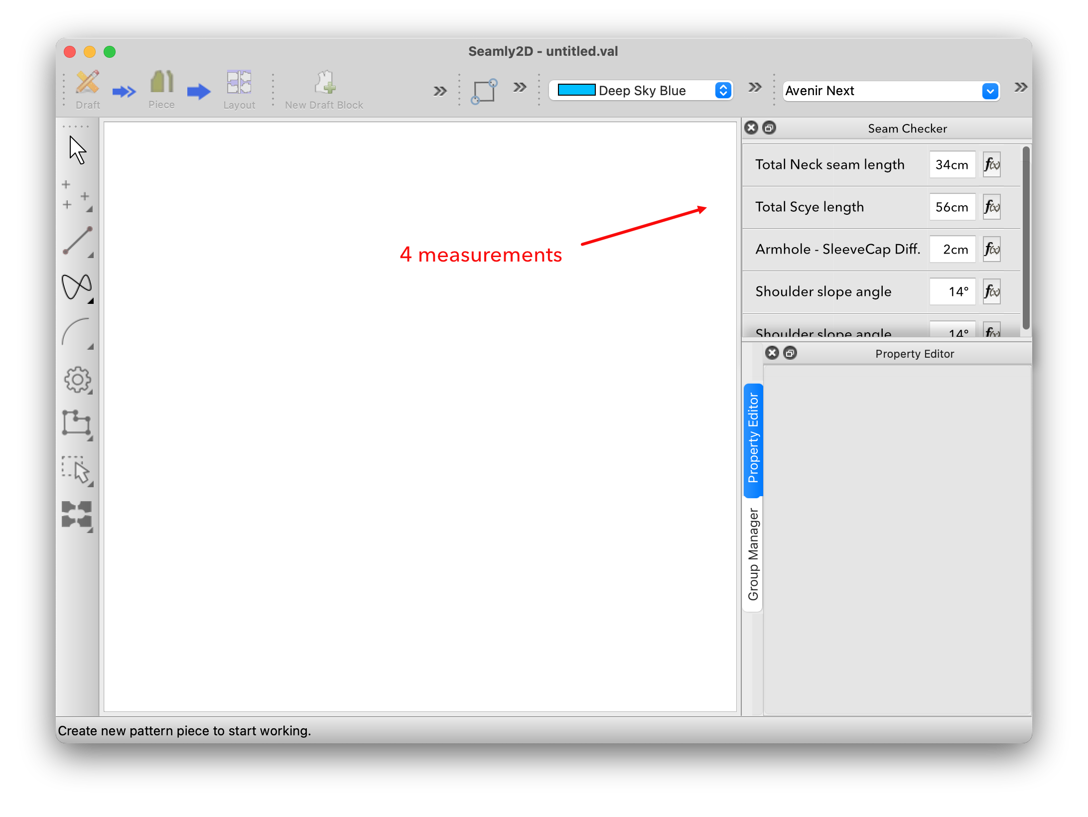

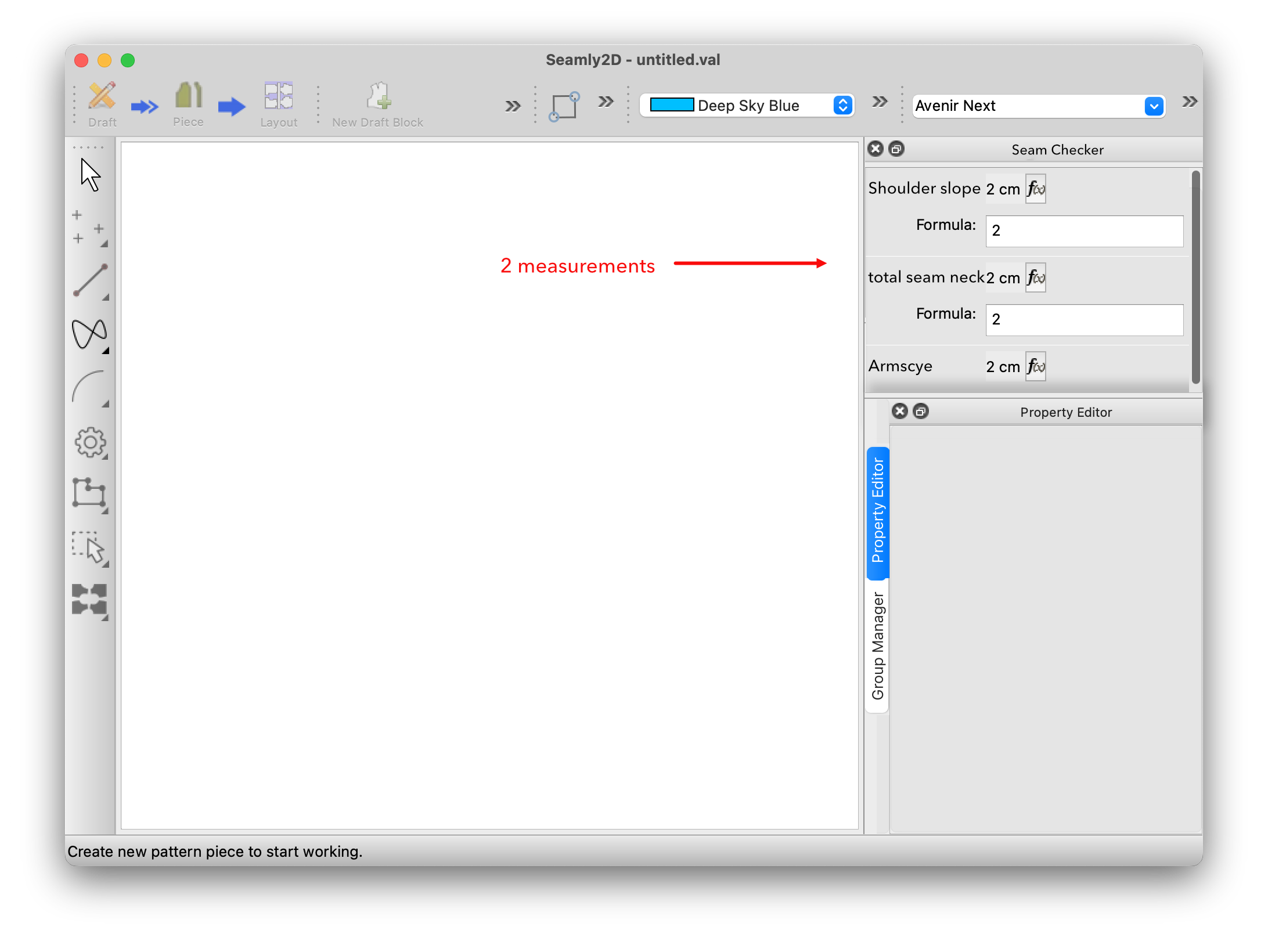

If you have also the formula box always shown, while you can add the odd inch or two faster, you basically lose half the number of “comparisons” that can be shown at the same time, unless you have a big monitor.
IMO the compromise (since it’s a tool to check measures, while designing with other tools) would tend to go towards seeing more measurements. Adding the odd inch is just a click on the Fx button away.
compare the following, which are built using screenshot parts, all at the same scale:
With this:
Of course you can reduce the Property Editor, but showing the formulas will always eat more useful space

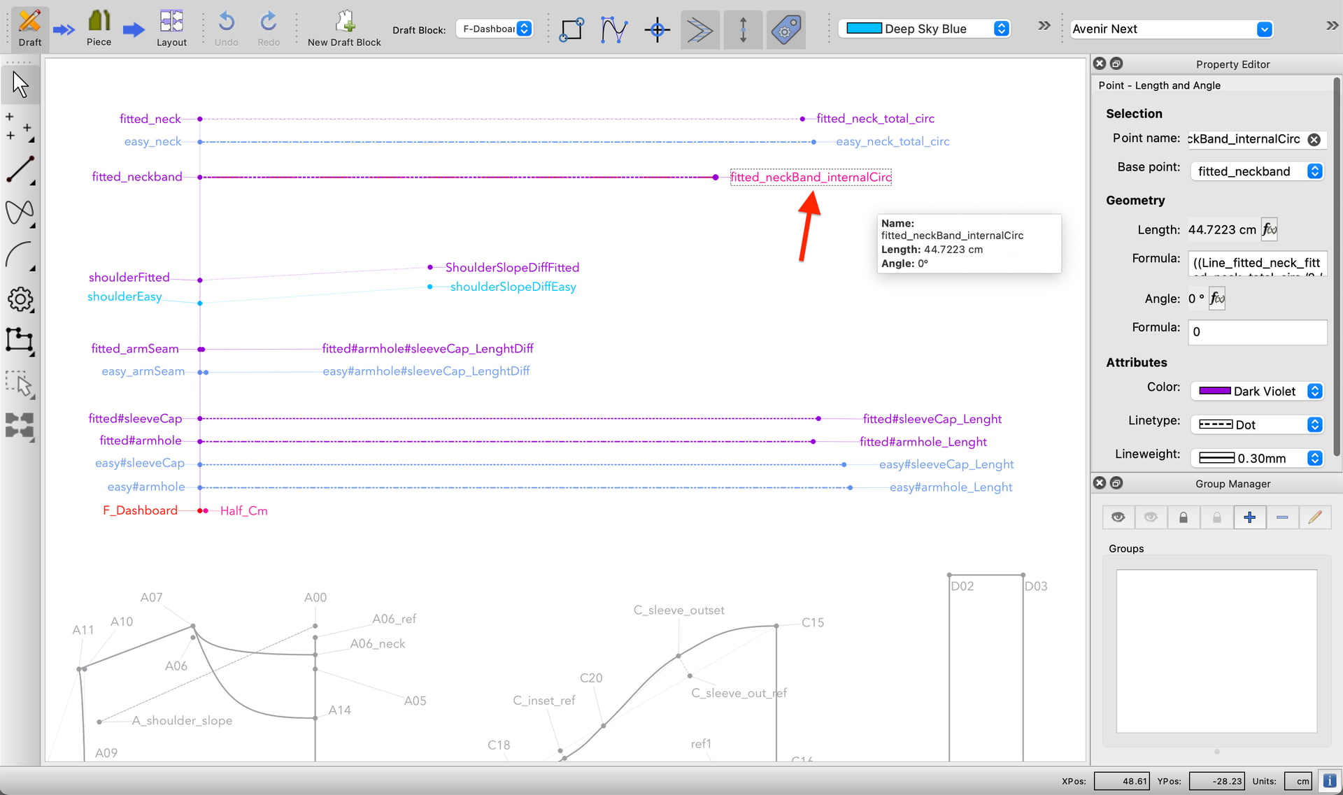

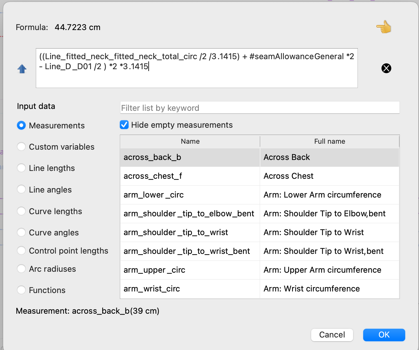

One example that would’t fit in this structure is something I just added to the dashboard I posted at the beginning of this thread: A formula to approximate the final neck opening (after applying the ribbed neckband) starting from the total lenght of the neck opening in front and back bodices:
this is the formula:
Basically I’m calculating the internal circumference taking into account the seam allowance and the height of the neck band.

And looking at your screencap… since you’re showing 3 different neck length calculations… that could be done with the Perimeter (Path / Contour… whatever the decided term is). You would just add the same formula you have now for each one. So now instead of having 3 lines of objects in some draft block, there would 3 Check Length widgets in the Check’s doc. BTW… I would think too the whole idea of moving this to a dock would be a benefit to the performace of the app as those neck lines don’t have to constanly be redrawn everytime the pattern is reparsed - which happens all the time.
