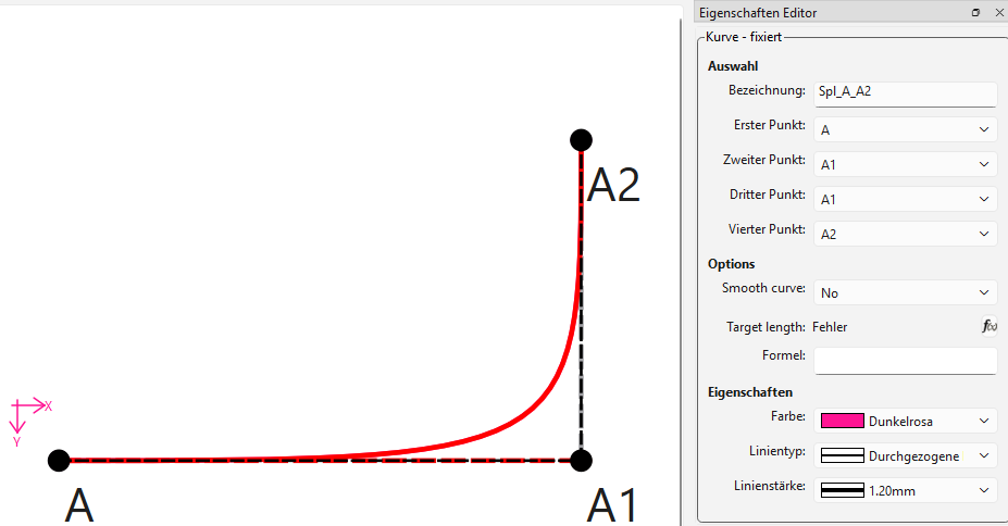

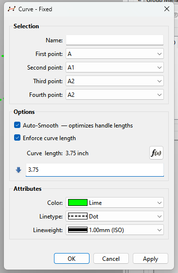

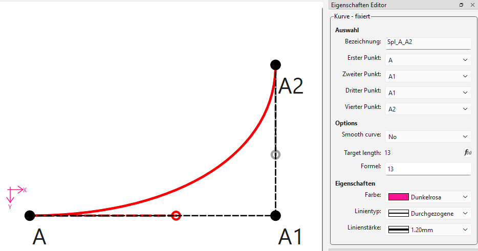

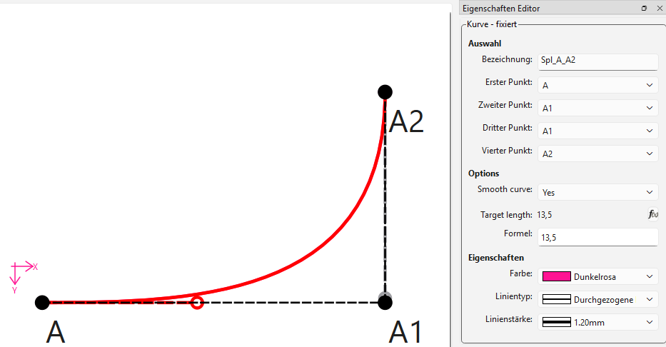

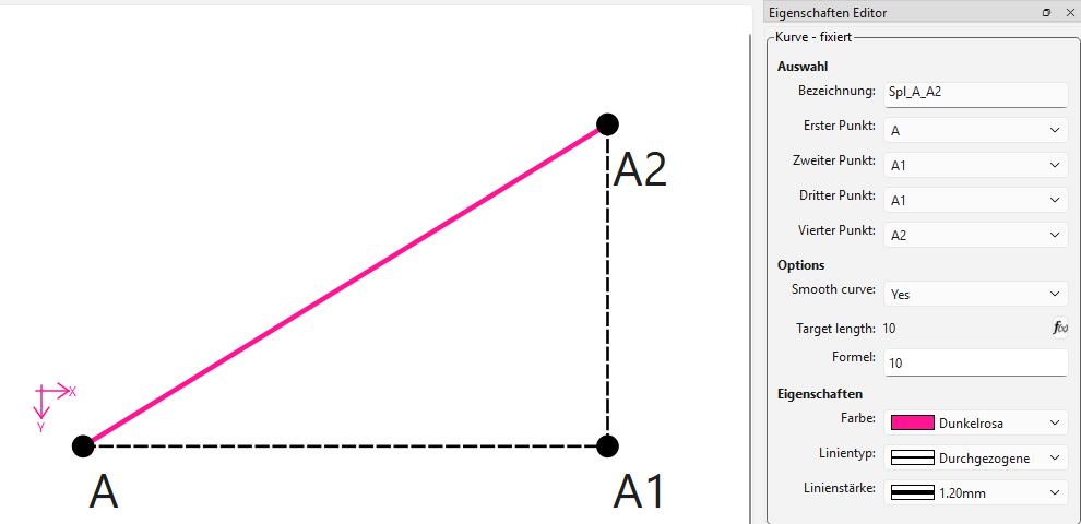

I got the featute to build but there’s a bunch of issues Ican see right off the top:
The addtipns do not show in the tool dialog:
But do in th eProperty Editor…which is surprisong as the Editor is normally a PITA to deal with.
The copyright notice on the dialogcubicbezier file has completly disappeared… and I can only assume other filres as well.

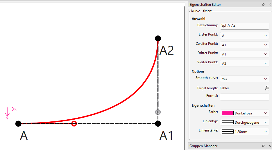

The target length formua is showing an error.

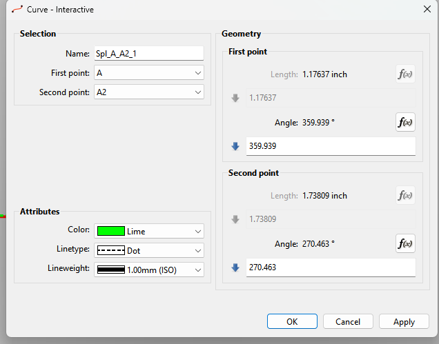

Theh curve name has disappered from the Tool Dialog:
Should be:

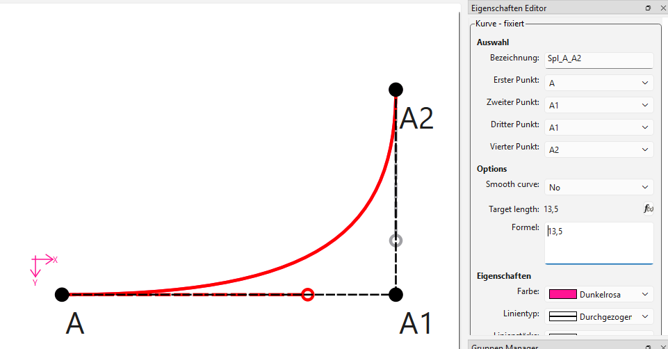

Even though there is a value in the Property Editor.. the fx Editr is emptyand displays error:
Ditto on the Curve Interactive… no options.
There is no “checkbox” plugin for the Property Editor, so the tools are usless without the checkbox option.
And as I thoufght, Claude has no clue how to edit the ui forms… that’s why there is no options in the dialogs:
3 polubienia
yes that is correct. I fokused on getting it to work in the Property-Editor. -The “Target lenght“ only activates, if the Formula is filled, but empty it shows “Error“. -The checkboxes never showed up, so I switches to a yes/no drop-down. Im not sure wether or not I did that for the dialog. -For the Issue with the name- i have no Idea how that could have happened. Same for the Edit-Formula-dialog :face_with_raised_eyebrow:
Other than that, does it work?
2 polubienia

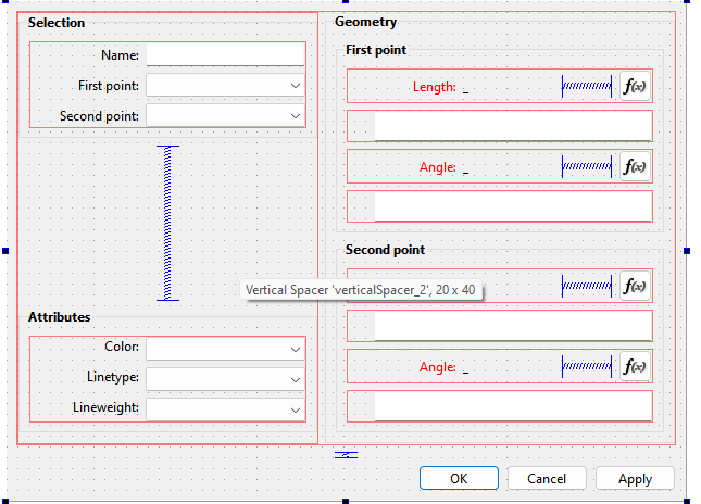

Man are the UI forms wacked out. The checkboxes here are up and off the upper corner:
1 polubienie
Right… the Property Editor does not have a Checkbox property plugin that I’m aware of. On the other hand the ui dialogs are all messed up and I can’t figure out why. They are in the ui form, but something aint right as they don’t show, and can’t be edited.

I found the issue in the dialogs… they’re not visible… because they are visible = false.
Name is still missing though… :thinking:
