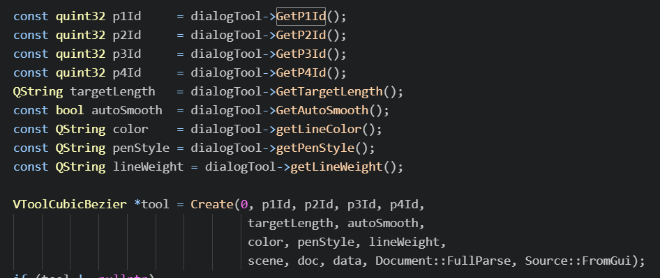

OMG… Claude mangled the hell out of the DialogCubicBezier file… besides what I posted above, it deleted whole sections and members - specifically sp1()… that’s why the name isn’t being created.
Also it appears it added a bunch of uneccssary get functions for the CubicBezierTool so it’s got this:
instead of this:
The only thing that should have changed is handling and getting the new check boxes and length formula. That’s it.
Why was there a need to touch the enums? No new tool enums were added and if they are they are added at the end of the enum list.

which returns the whole spline including the 4 points… you pass spl and extract the points:
there is no need to have 4 separate get functions to return the points from the dialog.
On the other hand there does need to be a call back function for the Prop Editor for each point - for ex:
each

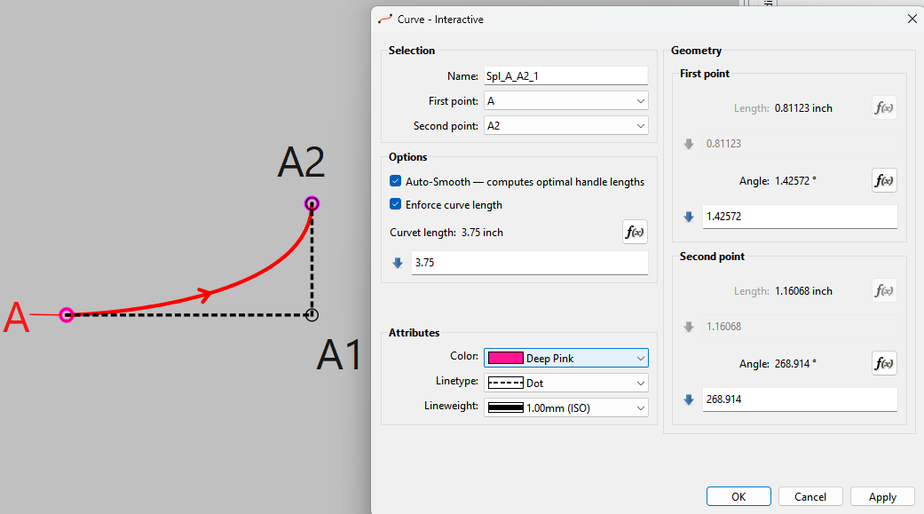

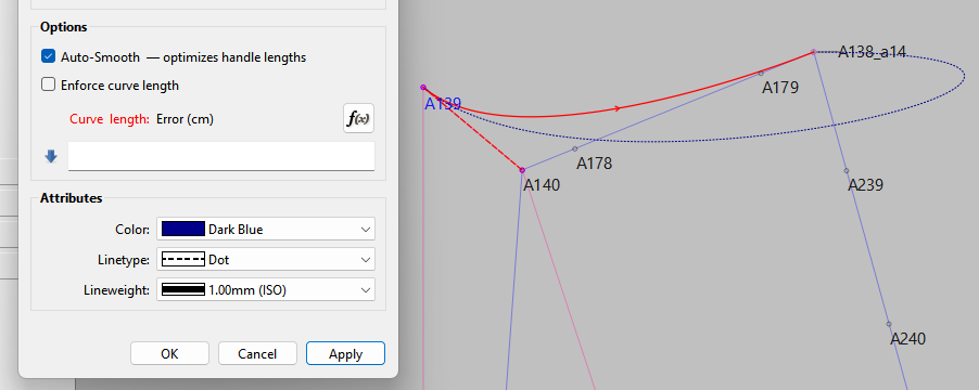

Found another minror bug… if the enforce length checkbox is unchecked when the dialog opens it’s not hiding the lengtht formula.

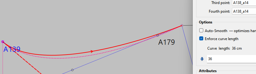

And another major bug with the Curve Fixed… the visualization does not match the curve:
And another major bug with Curve -Interactive. Unchecking the Enforce curve length does not restore the orginal curve.
And another… the Curve -Interactive. Apply button has no effect.
I have no idea how this is optimised?

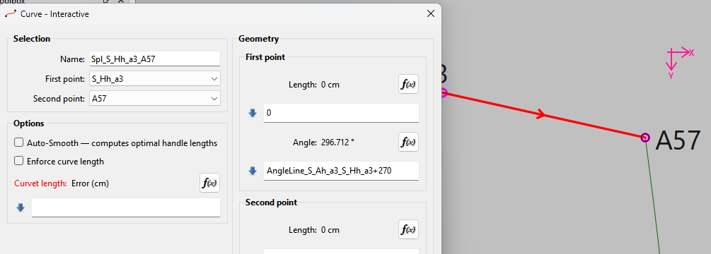

  • While a curve length formula can be entered in the Propeties Editor, it does not show in the dialog.
    Screenshot 2026-06-22 194455
    And the length value in the dialog does not match.
    Screenshot 2026-06-22 194516
