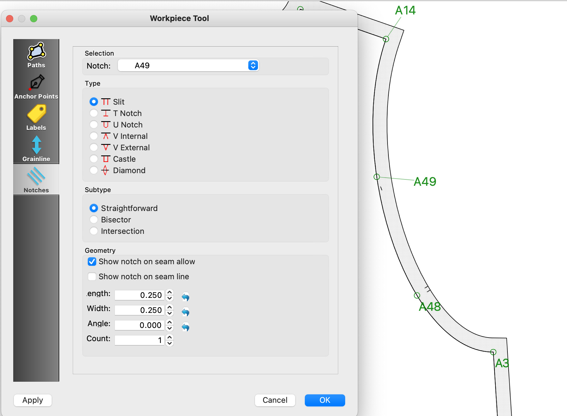

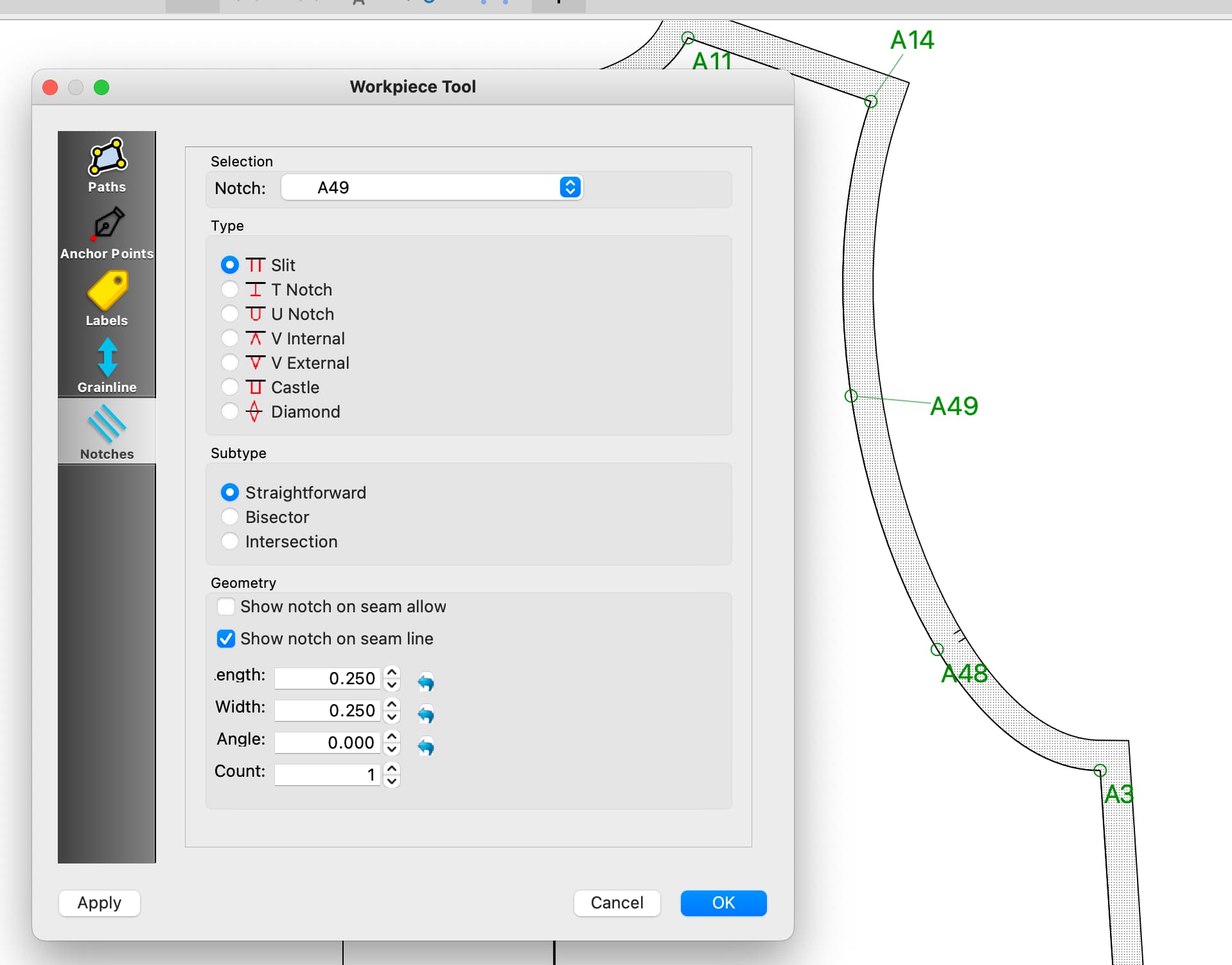

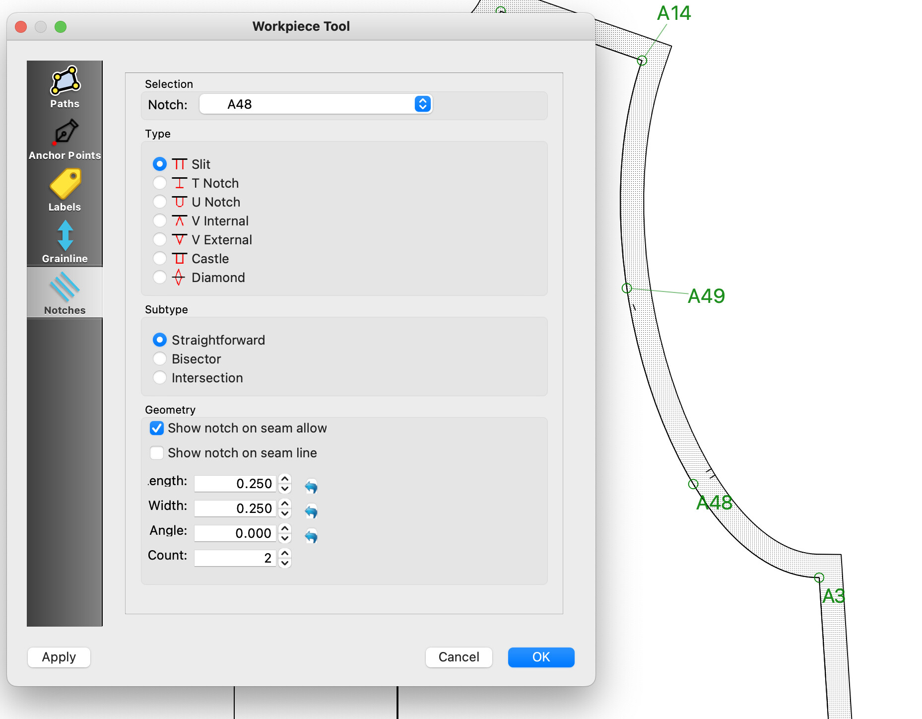

@Grace using Qt version 5.13.2 i am able to ad notch, insert nodes on pattern, and use fx. <=> hope this information helps @Douglas
i am still facing a small problem though which is that I am unable to control the direction or visibility of the notch, despite trying similar setting for A48 and A49. sometimes A49 isn’t visible despite the settings
There’s a legacey setting in the Preferences to show second notch on the seam line… this also has to be checked for the notches to show.
At some point I’ll remove the pref setting and just use the one in the Piece Dialog.
And thanks for the pics… I noticed that the one check box is not displaying the whole “Show notch on seam allowance” text. Since I’m currently working on the Pattern Piece Dialog I can fix that. :slight_smile:
