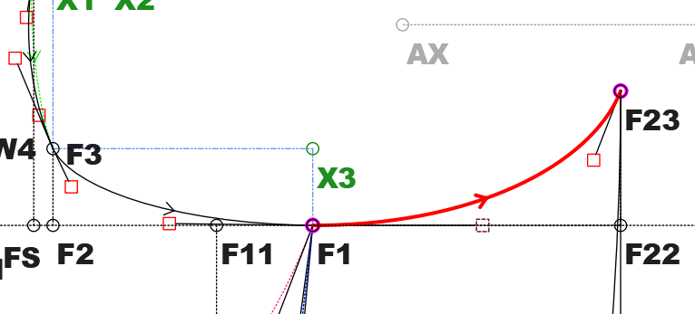

You may then be wondering well how would all this apply if you need to find those triangle leg lengths. if they not given? Well then you have to add points to allow you to have access to the line lengths as illustrated here:
Here you can see I needed a lengths for the curve between F3 and F1… so I added the point X3. Now I have access to Line_F3_X3 and Line_F1_X3 and the control point lengths become Line_F3_X3 * #bez_approx and Line_F1_X3 * #bez_approx. BTW… I could have just added lines F3 - F2 and F1 - F2… but I find it gets messy with over lapping lines.
Just another note… as you will run into this issue at some point - you need to define any lines you need BEFORE creating the curve as you can only access tools that have created BEFORE the current tool.
