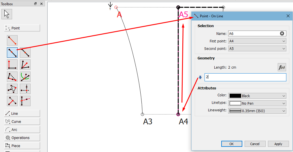

Firstly you need to place a guide point to establish the 2cm level where the stitches will go:
In the case of trousers, I’d use the Crease Line to do this and the Point - On Line Tool:

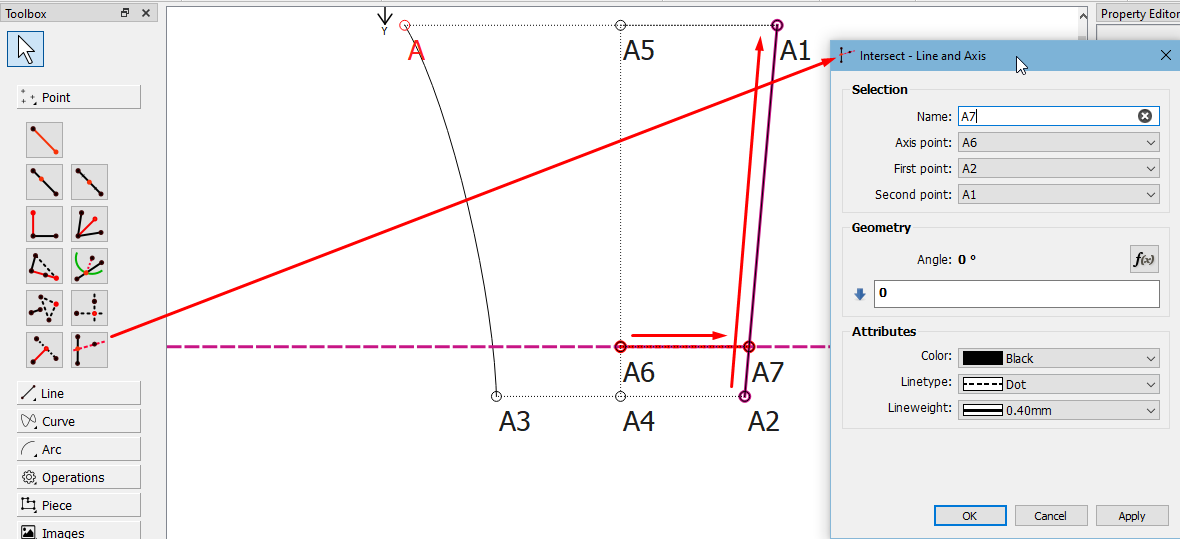

On the slanted edge, I’d use the Intersect - Line and Axis tool. Click the tool, select the 1st point of the line and then the 2nd point of the line, then select the point of your axis (the new point at 2cm from the hemline). Adjust the angle, if necessary:

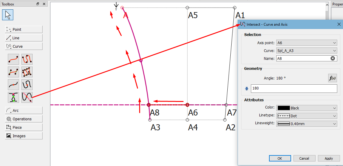

The next step is to use the Intersect - Curve and Axis tool. Click the tool, select the curve and then the axis point and, once again, adjust the angle to suit the other side:

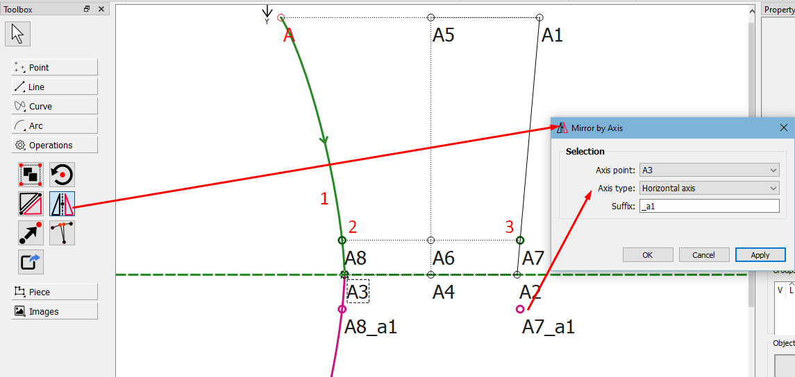

Now you are ready to mirror that section to the area below the Hem Line. Pick up the Mirror Objects by Axis tool. Select the curve, A8 & A7 (items to be mirrored), hit Enter, then A3 (or A4 or A2, it doesn’t matter), hit Enter and Select (in this case) Horizontal (if this isn’t a Vertical/Horizontal case, then use the Mirror Objects by Line tool):
