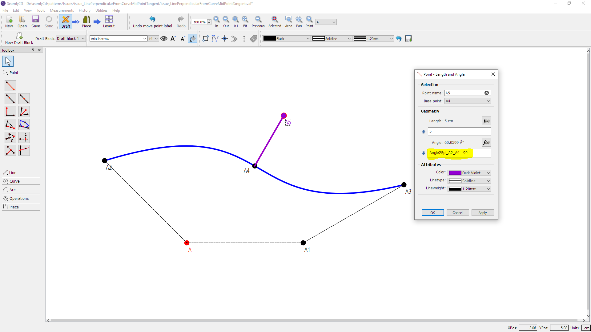

Found a way to do this.
Create the curve then use Point - On Curve tool to segment the curve with a new Point A4 . This creates two new curves that can be found using the f(x) button.
At point A4, the END angle of the FIRST new curve (or the BEGIN angle of the SECOND new curve) is the tangent angle at A4.
Create the perpendicular point A5 with the Point at Length and Angle tool, at whatever length you want and select the f(x) button to find the curve angle. In this example, select either Angle2Spl_A2_A4 or Angle1Spl_A4_A3 then add or subtract 90 degrees as needed.
Neat, but in the OP case A5 already exists, & A4 has to dynamically shift to keep A5 at the perpendicular.
DOH! That’s what I get for dropping into the conversation too late to catch the setup.
