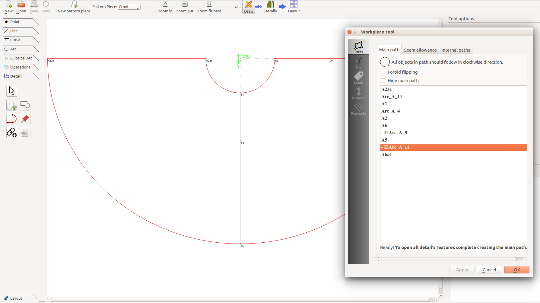

Hmmm… the points are actually in the internal path, but it appears that one can’t add a seam allowance to an internal path… and therefore even though points are set as passmarks, they won’t show up.
I’ll try taking a better look at it tomorrow eve.
Internal paths aren’t considered to be holes in the fabric. They are considered to be sewing lines (for pocket placement or contour darts) but not seam lines which require seam allowances.

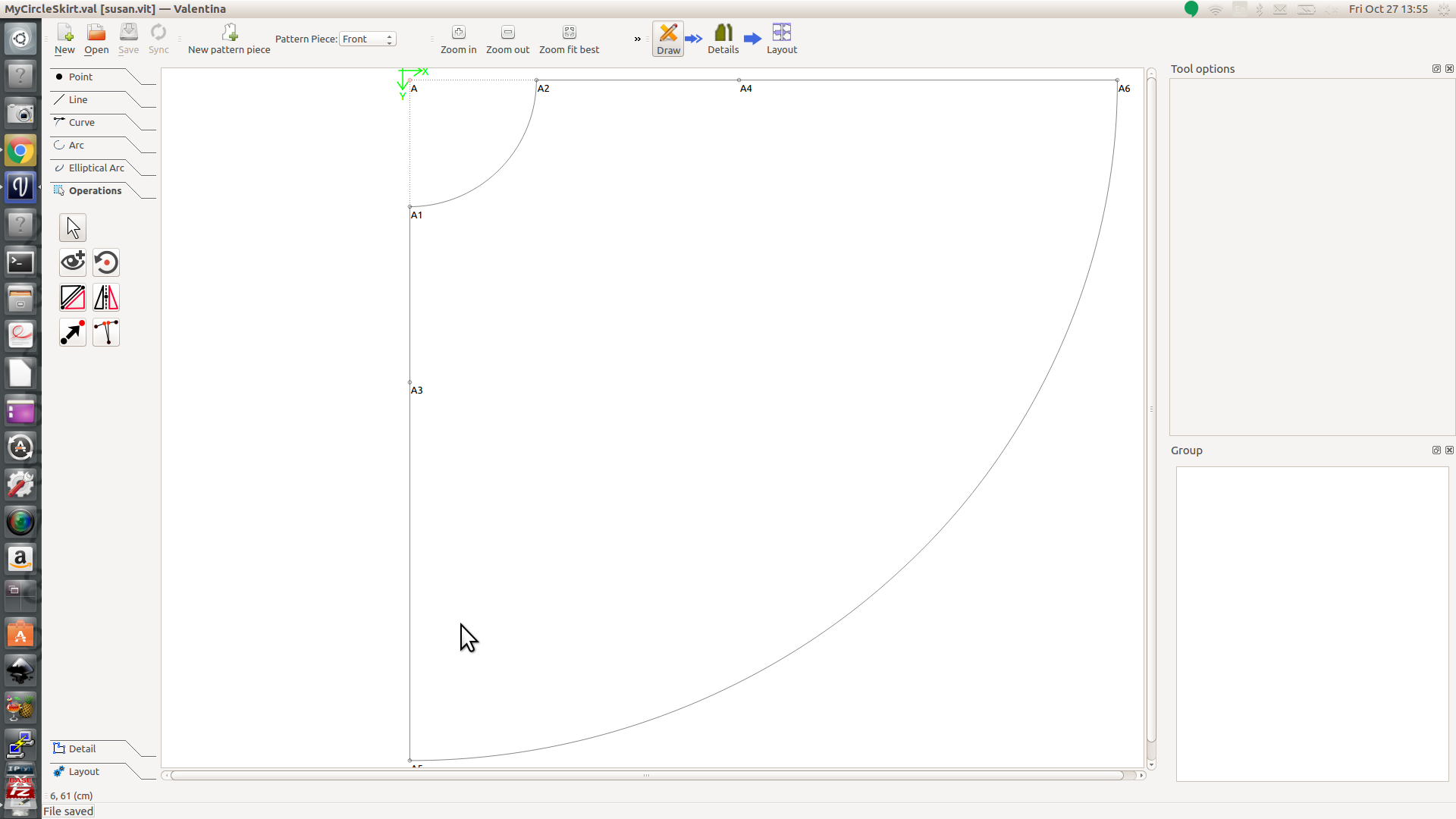

Ok, now we know the numbers to do this circle skirt! Let’s draft it…
To draft the front pattern:
  • Create A1. Point from distance and Angle. From A, length = (waist_arc_f*1.042)/_pi, angle=270
  • Create A2. Point from distance and Angle, From A, length = Line_A_A1, angle=0
  • Create Arc. From A. Radius = Line_A_A1. First angle = 270. Second angle = 0

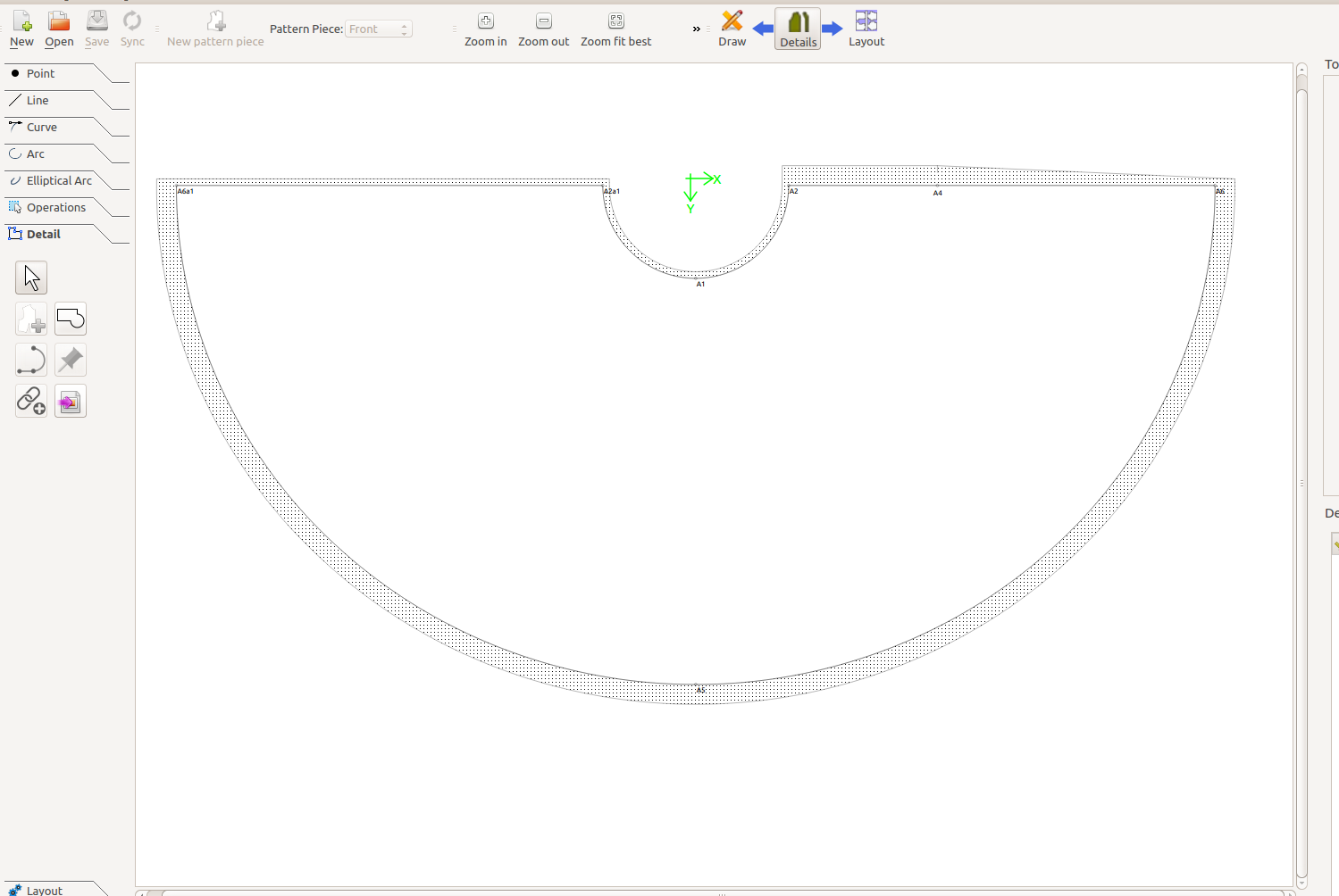

  • Create Elliptical Arc. From A. Rotation Angle=0. Radius 1=(Line_A_A1+Line_A1_A3+Line_A3_A5). Angle 1=0 Radius 2=(Line_A_A2+Line_A2_A4+Line_A4_A6). Angle 2=270
  • Note: the angles are reversed, angle1 should be angle2. this needs to be fixed.

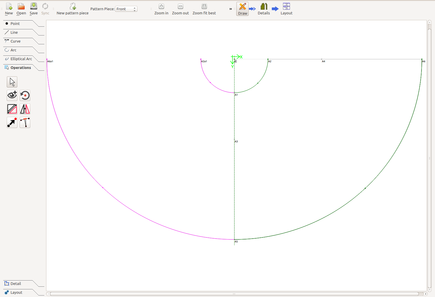

Mirror the front half using the Flip objects by Axis tooll:
  • Create mirrored points and arcs. Flipping objects by Axis. Origin=A. Axis=vertical. Select waistline, A2, A6, Shift+Hem Arc
  • Don’t forget: Add the side seam line, it won’t be mirrored

  • Create the seam allowance. SeamAllowance = 1. Hem depth = 3 * CurrentSeamAllowance
  • Add a wider seam allowance for the zipper, from waist to hip point along left side side. After A2, before A4, seamallowance = (2 * CurrentSeamAllowance)
  • Note: seam allowance doesn’t allow a distinct change between widths at A4. This should be fixed.

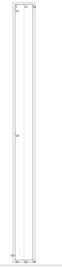

Here is the waistband. It is the length of the front half waistline + the back half waistline + twice the buttonhole width. I defined an “increment” that is 1.75cm and named it buttonwidth
The passmarks are placed one buttonwidth from each end. These passmarks indicate where the waistband ends will overlap over the zipper. They extend past the edges of the left side seam by one buttonwidth each.

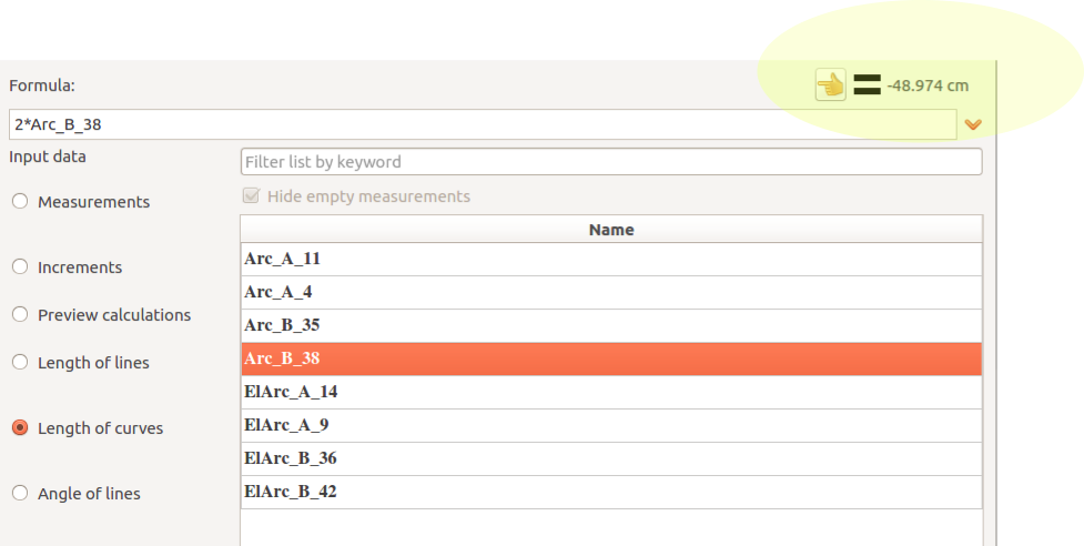

The middle passmark shows where the waistband matches the right side seam. From C4, it extends down the line by twice the back waist quarter waistline, in my pattern that is 2*Arc_B_35. Note: The length of mirrored arcs is listed as negatives, so you can’t use them in formulas. This should be fixed
The buttonhole is marked as an internal path. It begins exactly over the left side seam, and extends towards the front for 1.5 * buttonwidth cm.
Mirrored arcs have negative length. this should be fixed.

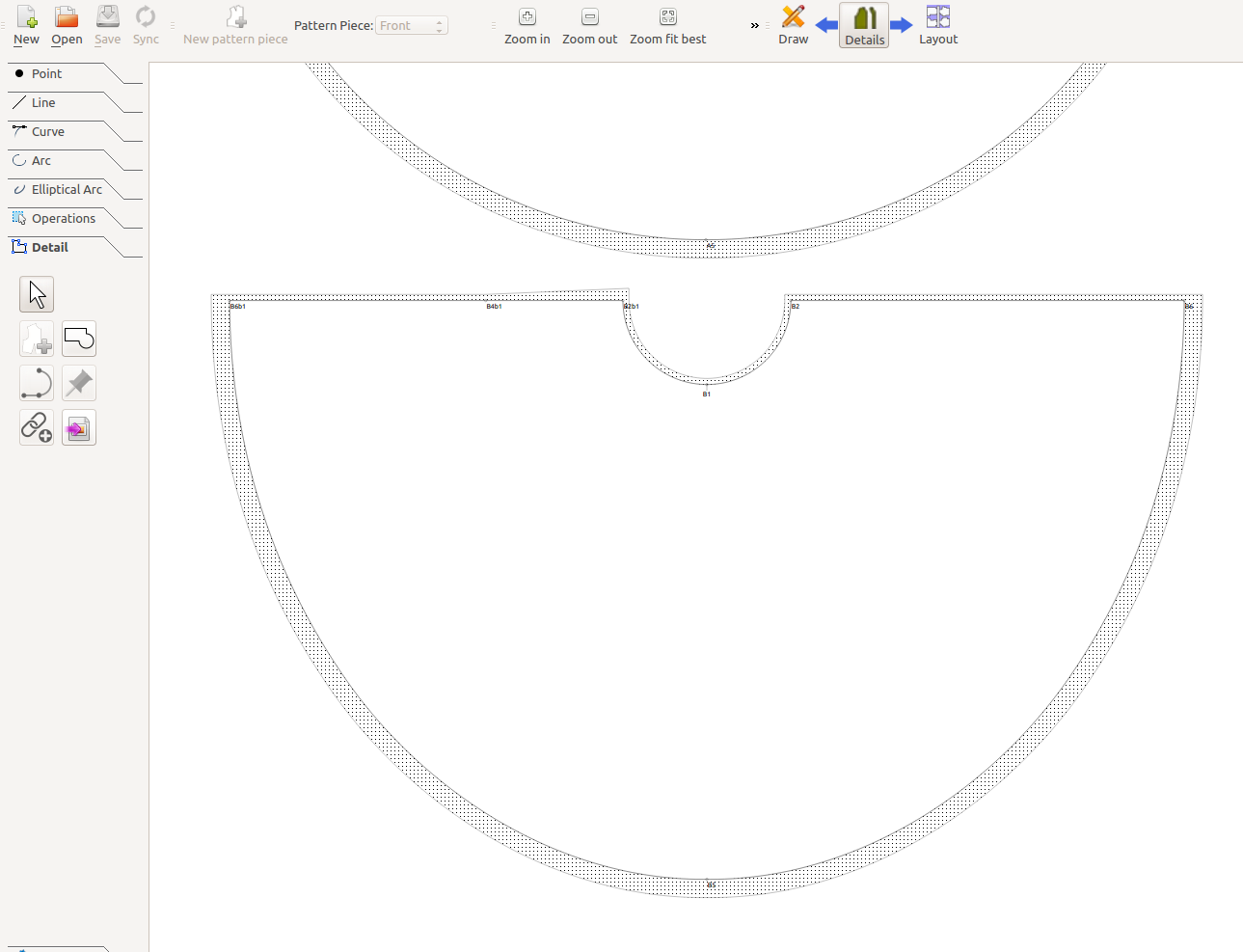

The only way to draft a full circle skirt without seams or without using an internal path is to draft half and place it on the fold.
That said, here’s a work around solution to use internal paths to show the waist seam & allowance, plus notches (IMO passmarks has to go - it’s just a confusing term). Instead of drafting the waist band to measurements, I used the length of the waist seam curve… then added extra seam allowance on one end for the underlap.
CircleSkirt2.val (16.3 KB)
CircleSkirt2
They should be… There are cases where it’s necessary to cut a hole - of whatever shape - inside a pattern piece and allow for seam allowance. For ex: a square cuff at the end of a sleeve on a colonial dress… or for a waist band on a felt one piece full circle poodle skirt. :slight_smile:

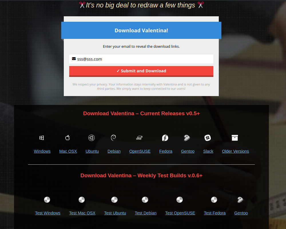

Download software from our website. Click on green download button, then enter email and submit. Then you’ll see the download icons. Select the test build (lower row) for your operating system to get v0.6.0
