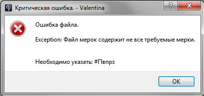

Hello, After I changed the name of an increment by mistake, the program crashed (some formulas use this increment). Trying to open the pattern I see the message (The measurement file does not contain all the required measurements. #Пвпрз is required. This is the measurement i changed.) After I click OK, the following message appears: File .vit cannot be found. However the file is where it used to be. And there appeared a file with the suffux .val.Ya2544. How can I open the pattern?
Your file is corrupted. Valentina can’t replace increment name by itself. So, when you changed the increment name you broke pattern.
But you can easily open the pattern file with common text editor, find all wrong names and replace them on correct.
Thank you! Now it’s OK.
I will add checking to prevent such cases in future.
