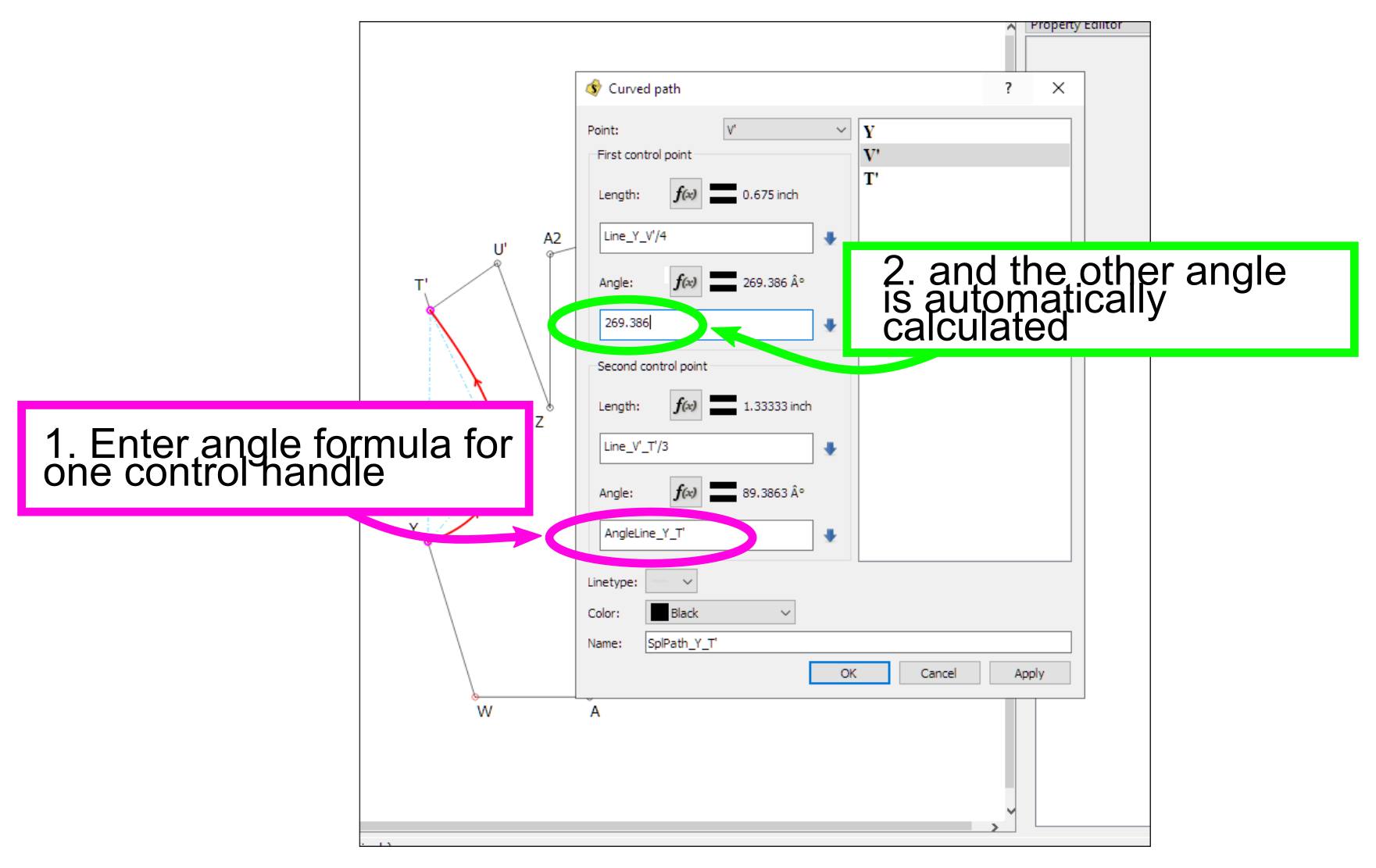

image image image
One last thing you need to know about creating curves with multiple segments:
Enter one angle formula at any midpoint of a curve, and the midpoint’s other angle is automatically calculated and appears as a number. The number is a calculated value that will change with respect to the angle formula.
