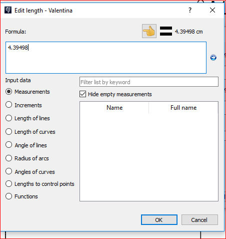

When going into the function window it would be nice if the window opened large enough that you can actually read the options you can choose from and/or have it save the size when you manually resize it so you don’t have to resize it every time you go into it.
Also in the function window have it auto highlight what is in the box so that when you hit the little hand to move an option over or double click the option it overwrites what was there rather than having to manually delete it.

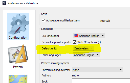

Have a global variable that saves the measurement type you want to use. So you could set in preferences that you want it always in cm or inches etc and every new project you starts starts with that automatically.

  4. We have the default unit already:

Which function window?[quote=“ladysinaz, post:1, topic:1350”] Also in the function window have it auto highlight what is in the box so that when you hit the little hand to move an option over or double click the option it overwrites what was there rather than having to manually delete it. [/quote]
As @slpencer said it will make more problems that solves issues.
You did not mentioned what language do you use. Also i don’t get where else you don’t like the name. And which names you see?
The field will be expend automatically if it more than 80 characters.

Yes it currently expands automatically if the formula is more than 80 characters.But it would be better if default behavior showed at least two lines for the formula. There is need for improvement here.

When I am talking about resizing the functions screen I do not mean where you type in the formulas, I mean when you have measurements selected and you see part of the name of the measurement and part of the name of the variable name of the measurement. Because a lot of the measurements start the same the only way to tell them apart is to grab the corner of the window and drag it over so you can read all of the text contained in there. It gets annoying quite quickly when you are in and out of the creating a pattern piece. When I resize it to where I can read all of my measurements, it would be nice if the next time I opened it, it would stay that size.
When talking about having the formula field highlighted by default I meant only upon first entering into the functions screen so you can easily copy over whatever numerical value the program automatically put there as you dropped your point. If you click in the field it would un highlight everything as normal and if you entered in a function either by the hand or double clicking it would also NOT be highlighted. Only when you first enter in.
For the size preference, I actually did see that a while back and set it. However I have it set to inches and when I create a new file then new pattern piece it is defaulted to centimeters. Not a huge deal but that would defeat the purpose of the global setting if I have to manually change it when I start a new file.

Don’t want to do. Use double clicking inside of formula field to highlight all.[quote=“ladysinaz, post:12, topic:1350”] For the size preference, I actually did see that a while back and set it. However I have it set to inches and when I create a new file then new pattern piece it is defaulted to centimeters. Not a huge deal but that would defeat the purpose of the global setting if I have to manually change it when I start a new file. [/quote]
Done.

tested some of it out… Awesome :smiley: I had a thought that the default unit should maybe be carried over to tape as well.
@ladysinaz - Tape doesn’t retain your preferences when you upgrade to a new version?
nope, it comes up in cm but everything in Valentina sticks to inches as it should
