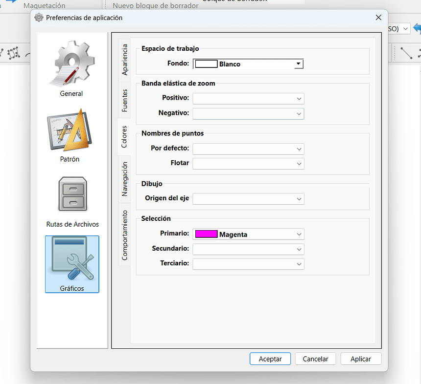

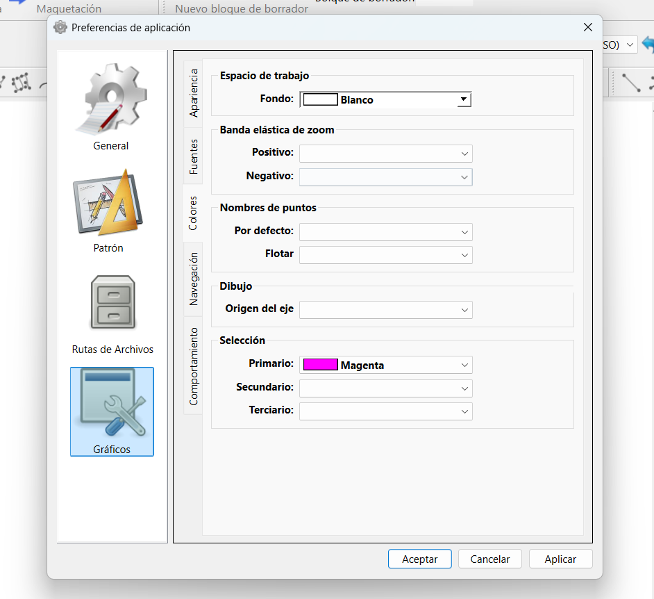

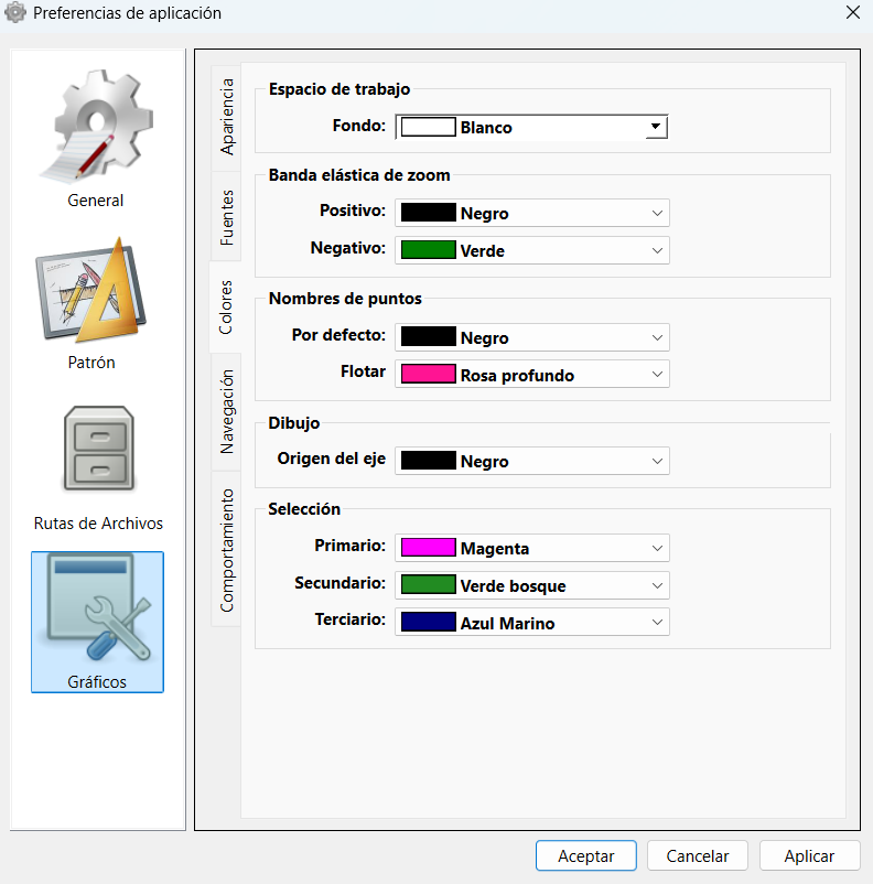

Si sirve de algo les muestro captura de pantalla con el antes y el despues de mi configuracion predeterminada.
Antes:
Despues:

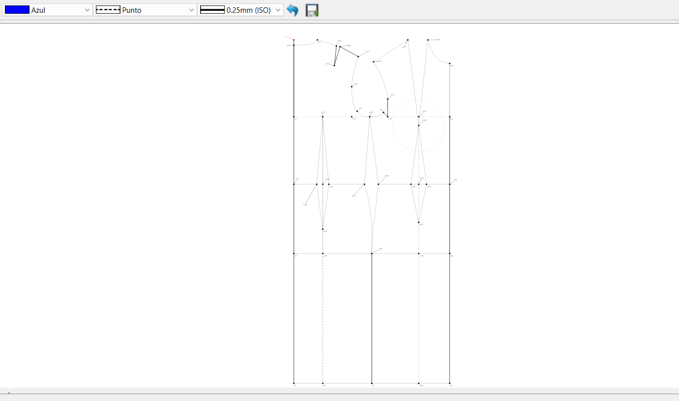

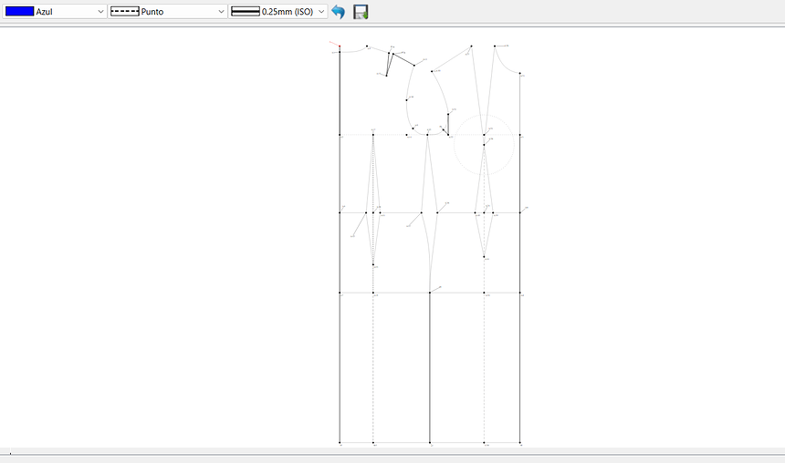

y asi es como ya abre el patron:

Yup. The blank dropdown boxes for the colors confirms there is no value set in the settings, so the box defaults to item -1 i.e. nothing… instead of a default color if the color was not set. Issue is now fixed. The new release (which also has a few other bug fixes) will be available next sun/mon or the pre-release is available here now:

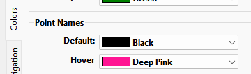

I’m happy to have helped. Now you may set those settings to any colors that you prefer.
