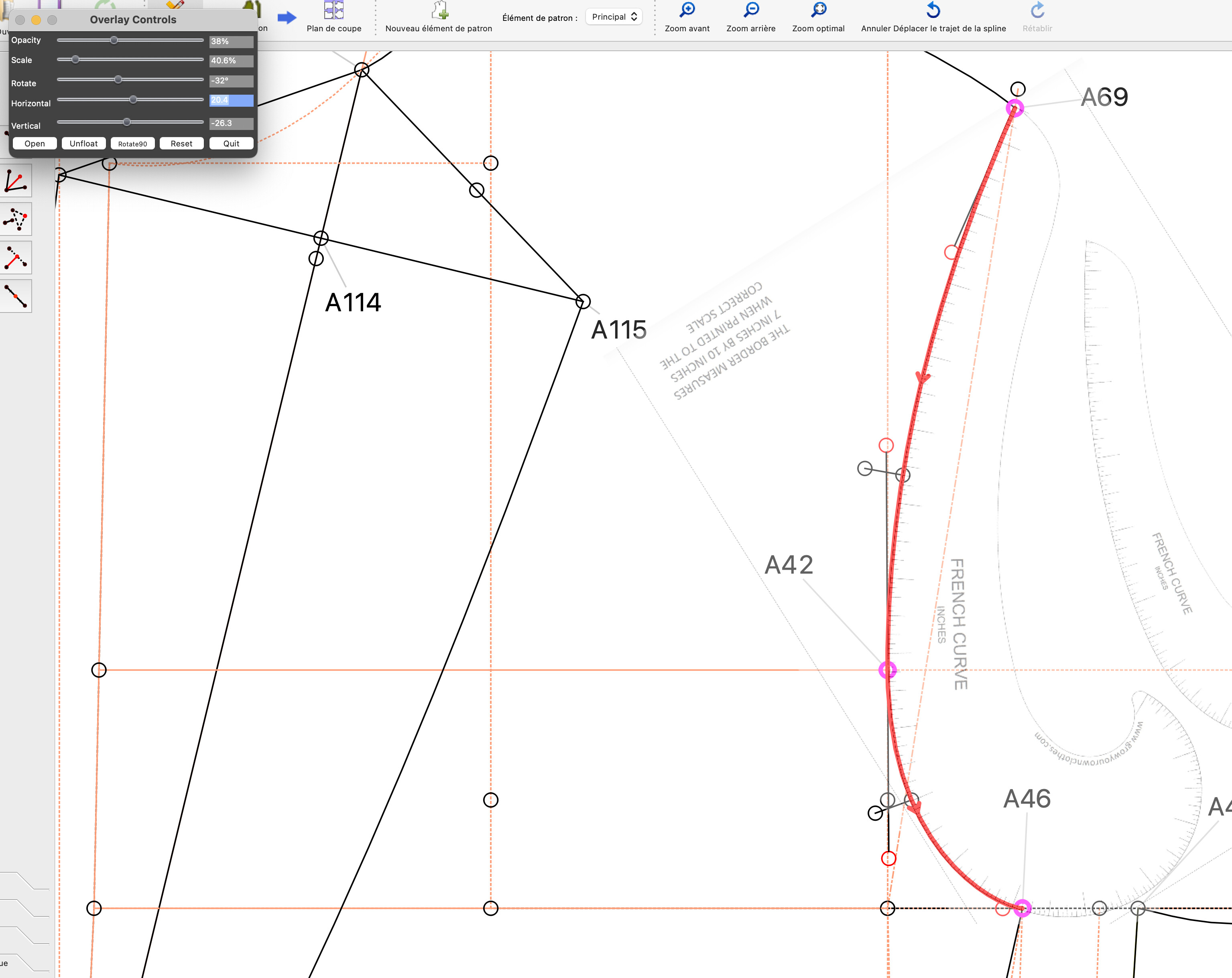

Meanwhile, to see transparent overlay windows (OSX / Windows) : Overlay 2.1 software, created by Colin Thomas.
The trial version is not too disturbing.
Best regards from Paris !
Nicolas
Looks interesting… but how does this help trace an image to a Seamly2D pattern?
Douglas, I only use the software to refine curves. :wink:
Hmmm… interesting. So the overlay program allows you to overlay another program on top?
As an aside… did you parametize the control points so it adjusts with a measurement file?
This gives me an idea though… a possible way to add french curves to the app to do what you’re doing in your example.
At any rate, what I have already working is a way to add a background image, scale it, positionit, rotate it, and set the opacity… just haven’t pushed the changes yet as I wanted an easier way to interactively set the controls rather than trial and error with the spin boxes. I have an idea though… I can add keyboard shortcuts to the controls.
Only a picture can overlay Seamly2D.
Unfortunately, I can’t adjust the control points with the measurement file - freehand, only !
“a possible way to add french curves to the app to do what you’re doing in your example” : it would be great (thank you so much) !

Ahh. Ok so the overlay program is putting an image on top of Seamly. Makes sense now.
Thanks for the curve pdfs. What I have in mind is having a preset number of french curves a user could select from a drop down, and it gets loaded as an SVG background. That way the curves are embedded in the app, and it would be an easy way to select one.
What I really need to figure out is a way to be able to select a point on the background image and snap it to a pattern point - such as the basepoint or in the case of a french curve select a point on the curve, and snap to for example a point on the armhole.
