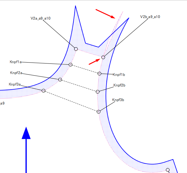

Points V2a_a9_a10 & V2b_a9_a10 aren’t attached to the curves for the neck and the armhole. There are multiple curves and arcs on top of each other, so the incorrect ones have been chosen for those points OR you need to make 2 new points on the curves used. You can use the History to put them in just after the operation that created those 2.
I suggest that you have a “Steps” group where you can hide all of the intermittent steps so that they don’t confuse when you’re creating the pattern piece.

It isn’t the node order, but rather that the nodes don’t connect firmly to the curve used in the pattern piece. So the curve goes past the nodes causing those spikes and Seamly spends a lot of time trying to find the connections.
I’ve repaired those shoulders but there is still something slowing it down. I’m just looking for it now.

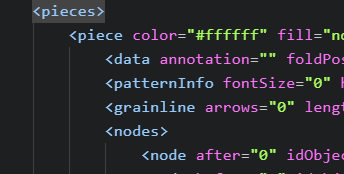

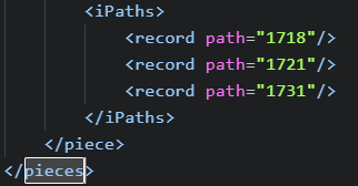

That said… when you say " I’ve deleted all the pieces – which took an awfully long time " you can just edit the xml text file and delete the <pieces> for a draft block.

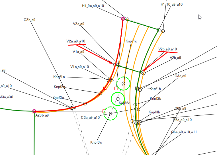

Once again, you’ve used a point at the end of a curve that isn’t connected to the curve.
If you use this point (it’s label was hidden) then your pattern wouldn’t slow down:
Here, you can see that the seam allowance is now going nicely square.
Now I need to find the other side of that curve & repair it & then do the right side pattern.
Both are now nice & clean. But there’s something else slowing things:
And… Here they are:
I can’t see anything else that’s out & the pattern is working fast now, so I think they’re all corrected.

Ok, so this part has a problem, too.
Here you can clearly see that the curve doesn’t pass through those 2 points. To fix this, you need to use the Intersect Curve & Axis tool to place a point on the curve and then replace the points used in the pattern piece with the new points.
Once again, I’ve fixed those 4 points, however, only 2 were used in the pattern piece.

Yes, this is what happens when you tell the pattern to use a curve but don’t attach it to any points. It runs up & down the curve searching for where it’s attached, doesn’t find it and keep searching long after it has given you something to work with. Do this with multiple curves that don’t have starts and ends, and you have a really slow computer.
