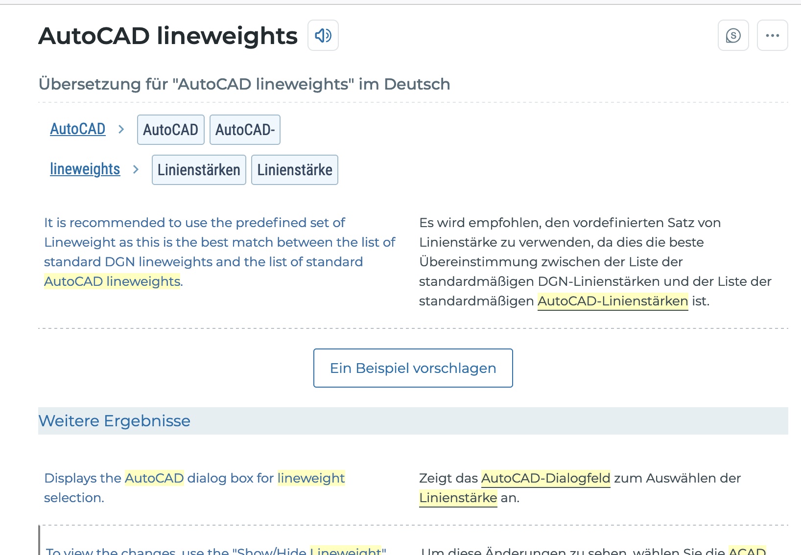

A nice site for searching a translation is www.linguee.de it will show several sentences with the word.
So I searched for lineweight and found the right translation Strichstärke. And some others wich apply to power lines and so on.
Thanks Bernt.
Currently it’s “Linienstärke”… but I’ll leave it up to you German speakers to decide what’s more appropriate. I’ll just do what I can to facilitate updating the tramslations. :slight_smile:
This site is using DeepL to translate. Which I have found to give more / better tramslations than Google translate.

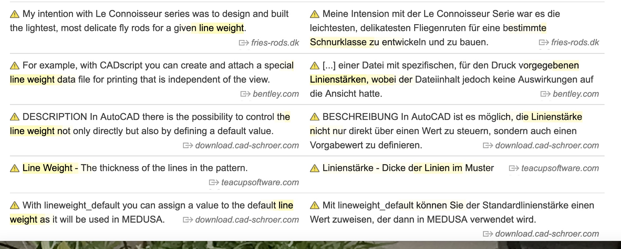

This would also be possible but I would prefer the other. As long as nobody chooses Leitungsgewicht :upside_down_face:
Just for the heck of it I checked the German translation for Lineweight in QCad, and it’s “linienbreite”… which in DeepL it translates to “Line width”.
Which is acceptable, but is semantically different from Lineweight. Lineweight is historically a drafting term, and implies more than just how wide a line is… it has to do with how much pressure (weight) you placed on the pencil - the more “weight” or pressure, the wider the line you get as well as how dark or opaque the line is. Of course with CAD these days it indicates the width or thinckness of the line. IMO I again prefer the use of the accepted technical terms. For example: we “draft” patterns, we don’t “draw”: patterns. Artists draw pictures. That’s why there are “draftsmen” and not “drawsmen” - which would be a totally non sensical word. Thus the use of “draft block”.
That being said… we could make the argument that the “Line” part in Linetype and Lineweight is implied and thus redundant where the line attibutes are simply Type, Weight, and Color.
For the thickness of a line, I would use “width” which would be translated to Breite.
With lineweight I would expect more changes than only the thickness, like darker color or an other type of a dashed line.

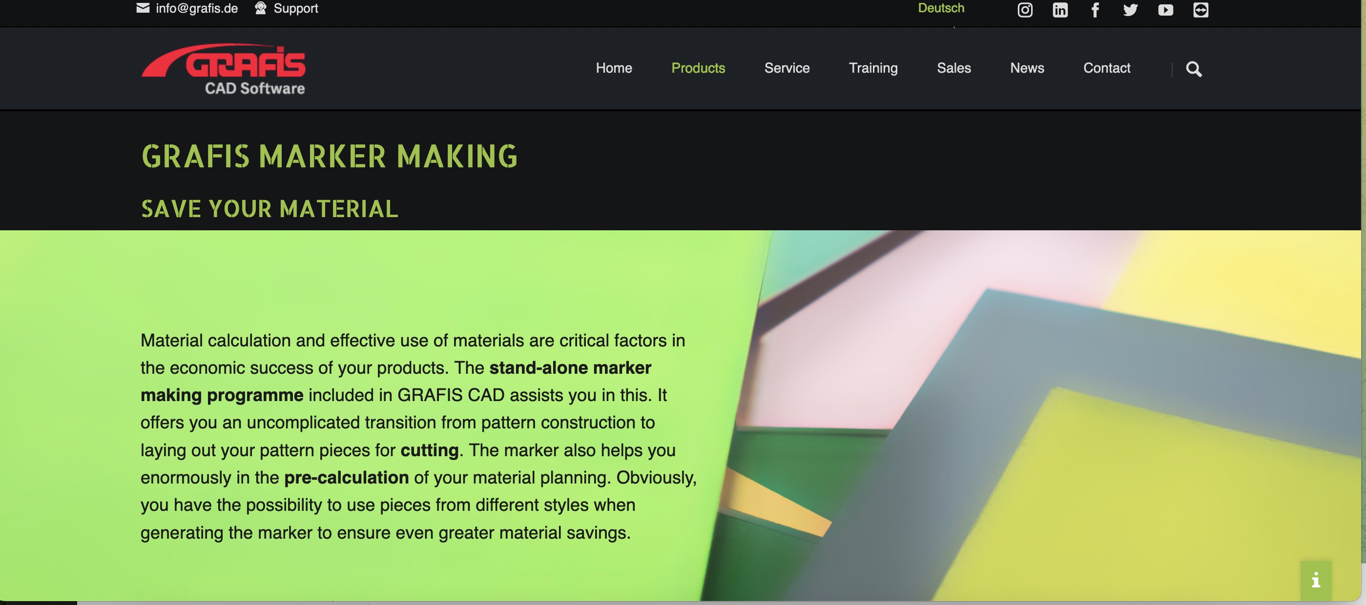

https://www.grafis.com/home-en

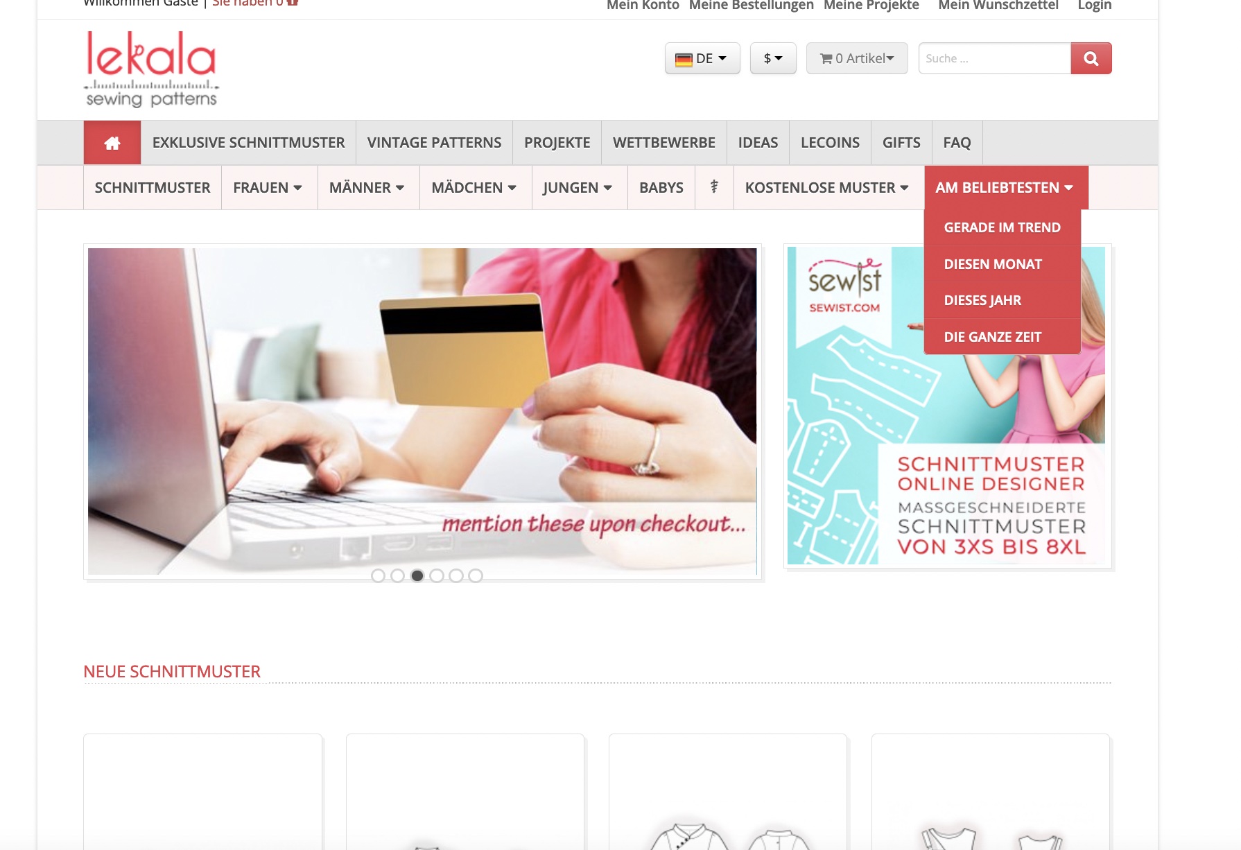

https://www.lekala.co/?lang=de
This are thre pattern making programms available in German amd emglish, I made the screenshots from the english. website. I could be helpfull to look there to find oud the translations. ohterwise it coudl happen that tialsor or Fashion designers who do construction will be amused about our designations.

@Douglas , sorry for my replay but I looked in linguea, which is definetely a bit not always up to date
but even there and also in its always Linienstärke esp as a technical term in CAD Systems, so dont do your research in that way as it will destroy the german translation, and believe me I did my homework very well as one of my friends works as certified Translator for english and frensh
I was just pointing out that the QCAD application uses Linienbreite, which as I pointed out translates in DeepL to Line width. That being said - My educational background is in Civil Engineering and then Technical Theatre - so I’ve been drafting for well over 50 years. Like I said I prefer to use accepted technical term(s)… in this case Lineweight. So I agree with you. :wink:
