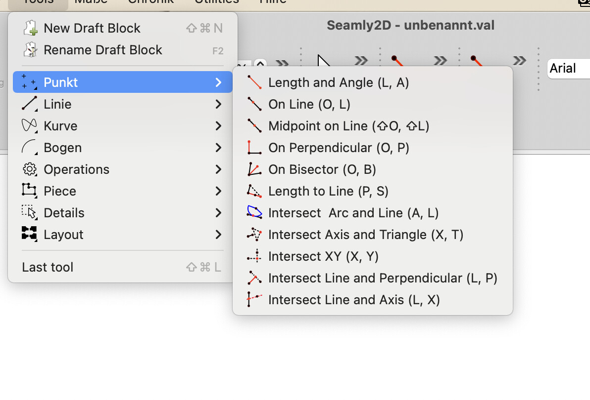

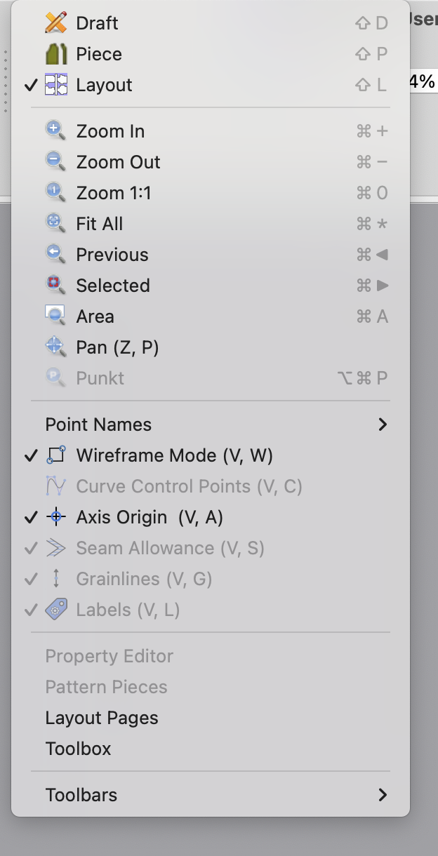

Hello everybody, as a german native speaker I tried to get used to the incomplete translation of the program surface as a mixture ofe english and german, named Dinglish (thats the naming a famous American comedian who lived and work for many years now in Berlin, named Gayle Tuffts, has given to her language mixture of English and German.) But to be serious again. I would like to help to continue with the translation to finish this project. Therefor I would be thankful for information how I can do that. and who is involved in this translation projekt. Bildschirmfoto 2023-08-10 um 23.52.50

@csett86 , @Douglas , I will finish the translation tonight and send the File to @csett86 so that he can make a final controll. It was not that easy as I thougt due to an incomplete and inconsistant dictionary. e.g the word name hes two translations in the German language: 1st Name (mormally used for whats your name so for Living creatures (also pets). The second translation is designation (Bezeichnung). the name of a point is in my opinion a Designation and not a name. But in the german dictionary was already name and Bezeichnung and the existing translations where name and Bezeichnung mixed.
Another question due to the complicate German Grammer. There are some Informations or Instruction, like Do you want to continue. We have two translations for that, one is you (Du) as it used for friends, family and people you know. But for older People or peple you pay respect the more formally translation (Sie). I looked in some of my applications and Microsoft and adobe are using the more formal Translation, where as apple is more modern and using the more casual way. Some of the already translatetd sentences were mixed, so you have to decide which translation and change the translation into the one form.
And a final remark, the dictionary was like a swiss cheese, full of holes, there where less than 50% german translations existing. But I filled it with my translations.

what a surprise, due to my regular work I just updated seamly 2 D a few min ago and found the German Surface, And yes, I looked a bit around and found some Typos and as I mentioned before inconsistant translations for the same word. would like to help to finish it.
Agreed… I did notice inconsistencies with word choice or grammer in some cases. I assume that to be the result of multiple translators. So yeah… if you see were it can be improved - have at it. I can send you the most recent ts file, as there’s all ready a few additional translations needed.
