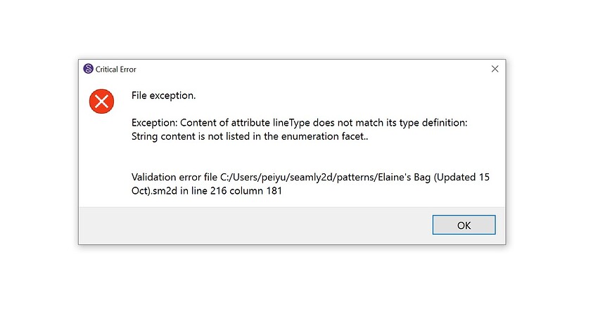

Hi! It seems like my file was not saved properly when I shut down my computer, and now I am unable to open it. Appreciate your help, please. Thanks!!
Elaine’s Bag (Updated 15 Oct).sm2d (56.5 KB)

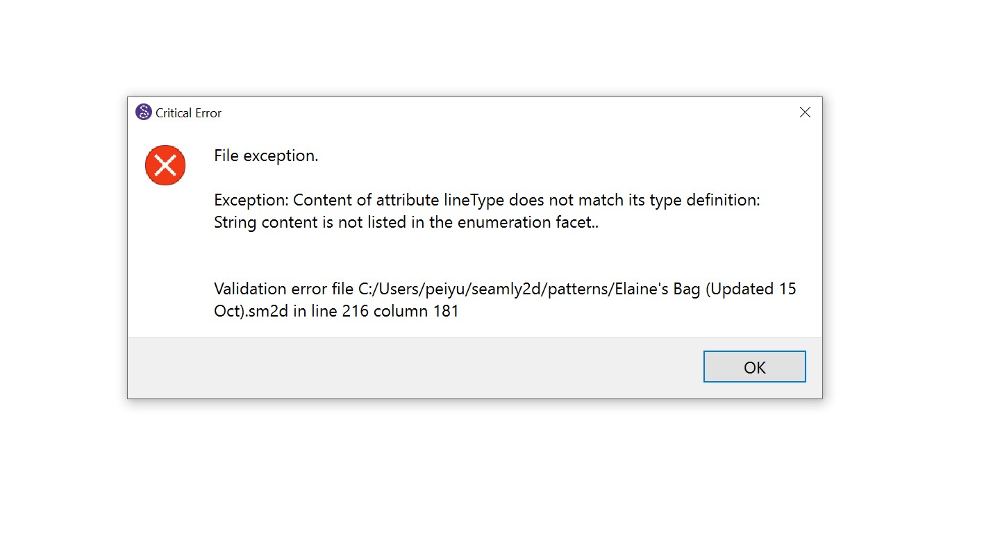

Hmmm. You have discovered another bug. Since internal paths can contain curves, which can not have a lineType of “none” , and you used the lineType of “none” in and internal path in the main piece… it crashes.
That’s what the error msg meant… or that “none” is not in the lineType enumeration list of "path"s. It also doesn’t make sense using a lineType of “none” for an iPath… just don’t add the path. I’ll have to eliminate that option from the dropdown.

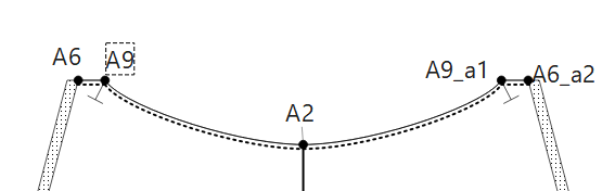

I changed the lineType to “dot” and it fixes the pattern:
Elaine’s Bag (Updated 15 Oct)_fixed.sm2d (57.6 KB)
