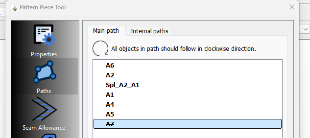

Now go to piece mode and open the piece’s properties and select the Paths tab:
where you wil find the added node(s) at the bottom of the list - excluded from the path (crossed through). We need to move it up to the proper order in the list… you can do this woth the move buttons:

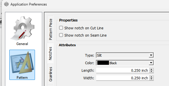

You can set the default preference of new notches in the Preferences:
