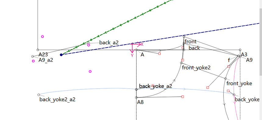

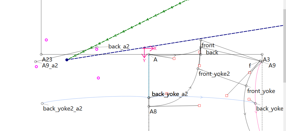

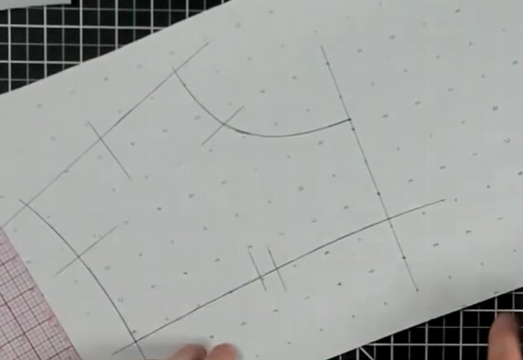

yes i was asking how to draft a yoke in this app, i am following this tutorial (pic1) to draft a button up shirt, where he cut off curtain sizes from the front panel and back panel and rotated the front panel and put them together to create that shape, i don’t know how to achieve this move in seamly2d, i knew there are functions like “mirror” “move” “rotate” but i just can’t get it to work, been sit here for literally a day to trying to figure this out.

It seems to me that you already have the front yoke drafted in your image - it’s only on the right instead of on the left - and the image doesn’t show if you’ve marked the bottom curve of the yoke.
The shoulder section needs to be mirrored along the shoulder line (Front - f) using the Mirror by Line tool and then moved and rotated so that the Front & Back and the f & A9 points meet using the Move & Rotate tool.
The move angle will be the angle of the line f-A9, the distance will be the distance between f & A9 and the rotation angle will be the line A9-Back minus the line f-Front
