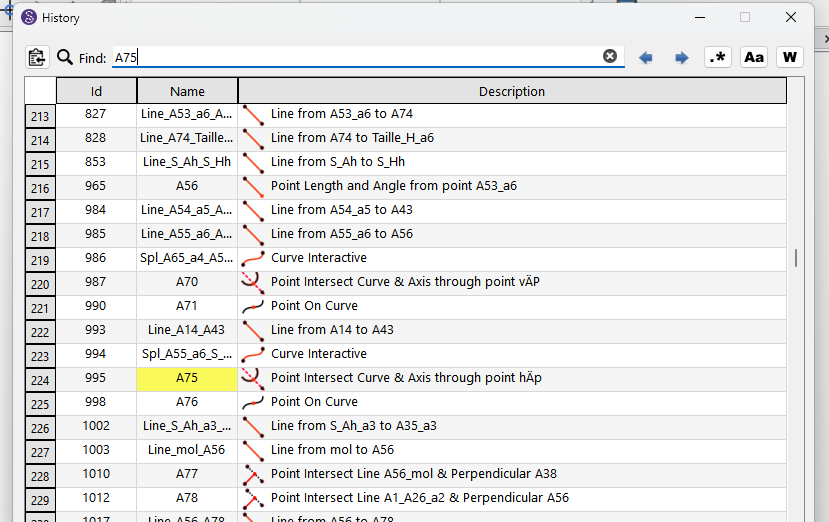

  • Find point A75 in the History. You can search with the Find box:
    A new tool can be added anywhere after row 224.

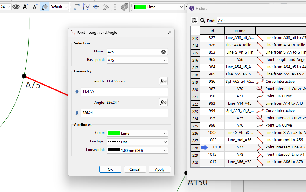

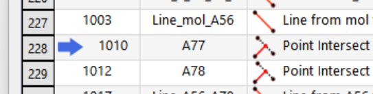

  • In the 1st column click the row at which you want to insert the new tool after. Here I clicked row 228. New tool will be inserted on line 229.

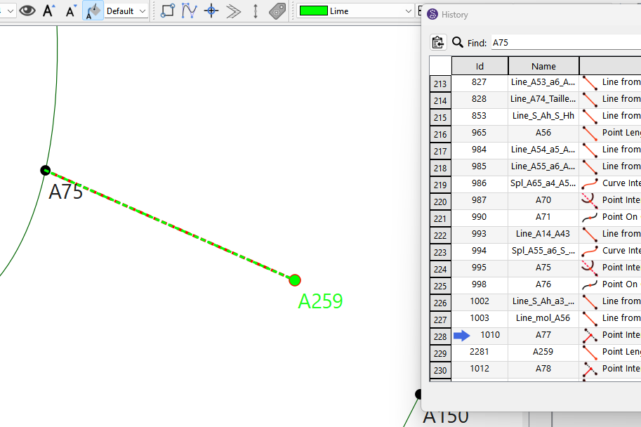

  • Draw your new tool… here I’m just adding a Point at Length and Angle:
  • New point tool A259 was inserted at row 229.

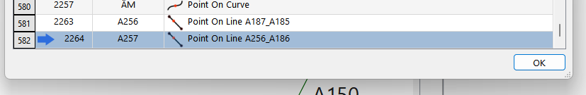

  • Before you close the History make sure to move the pointer back to the bottom of the list so new tools are appended and not inserted.
