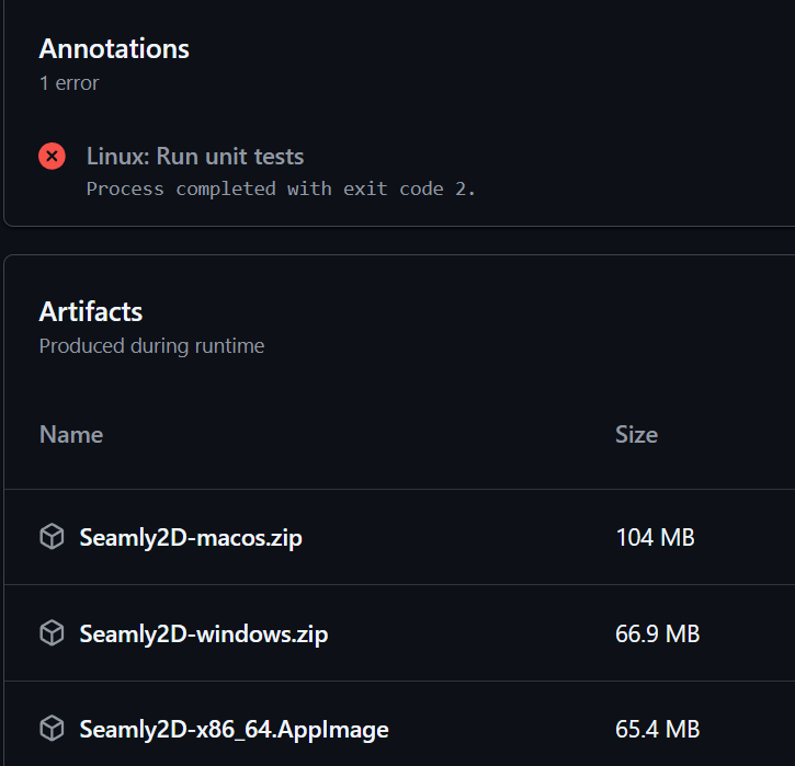

Actually for anyone with a Github account… you can download an “artifact” build anytime a PR is made. For example… I made this PR sometime last night:
and here’s the artifacts: Ignore the run tests… there were some minor typos in the translations that failed the tests. :roll_eyes:

I specifically made a PR to have Girhub build the Mac version as I don’t have my Mac Book setup yet to build locally.

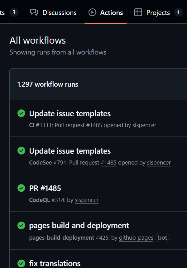

You can find the workflows under the Action tab…
The workflows marked CI are the actual builds where you can find the artifacts. The Codesee and CodeQL are just some AI generated stuff about the PR. The Pages build and deployment is the building of the Doxygen docs based on the updated source code. Which I’m reminded I should review the PR from Sue and get that merged. :slightly_smiling_face:
