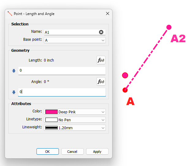

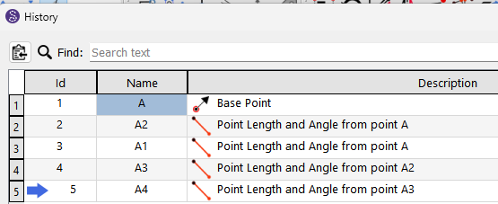

You are referring to the tool point names… not measurements.
That’s just how the name generator works. The app will use the current basename… in this case “A”, and then increment the suffix by 1. So normally it would go A, A1, A2, A3, A4… etc. Since you renamed A1 to A2… it’s going to go A, A2, A1, A3, A4… etc. The app is going to fill in any empty numbers, skipping over any existing numbers.
If you really need to skip A1 you can just create a dummy point with No pen linetype and hide the point name"
