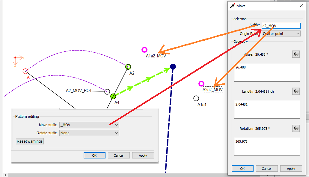

Here’s some screencaps of the prefs and a move tool with the move dialog:
And one with a curve…notice the updated Tooltip?
Spline_MOV

Let me see if I understand… you would want (using the example of the pic above) the lime green arrowed line to create a line that stays after the move tool is finished?
Can I assume you want to be able to use the line length or line angle in formulas?
Eventually. Currently the operations tools have no color for the destination items. Need to add a color field in the DestinationItem struct. Then I can add a color combo box in the dialogs to set the color for mirrors, moves & rotations.

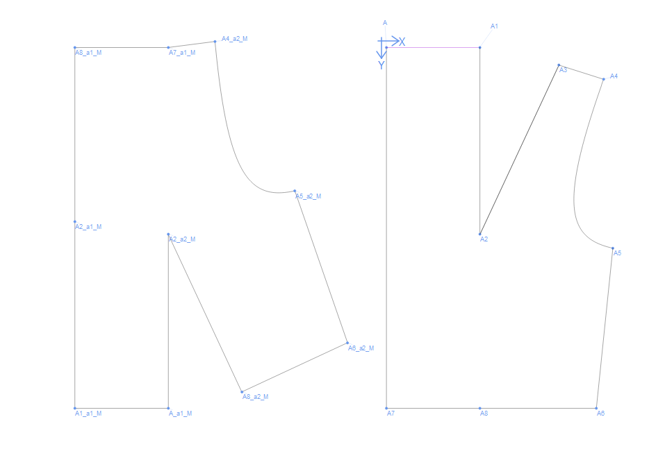

Fnally think I got this one finished… first had to figure out how to get rid of the old move origin point when the origin is changed in the dialog - had me stumped for a bit.
origin
Then while doing multiple iteration of the move tool I noticed I broke the point name suffix as the suffix was coming out the same. Had to change the suffix deeper in the code… in the process to make things easier I had to add the additional suffix types to the 2 mirror tools. Also added _M and _R as move & rotate options.
