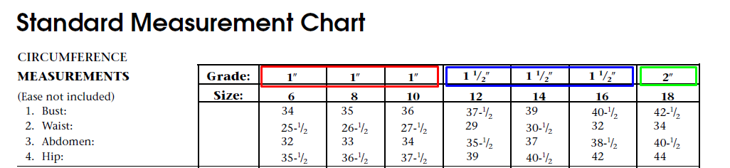

There are many Standard measurement charts on the internet, however, if you have already drafted those basic bodices in Seamly, then you already have a standard measurement chart.
All you need to do is to create a New file in SeamlyMe, select Multisize and your base size and height according to your standard measurements. Then add the codes for the measurement areas and (at each code) add the base value and the increment per size.
Then you can load the multisize measurement chart into your pattern and select the different sizes in the bottom right to resize the pattern.
