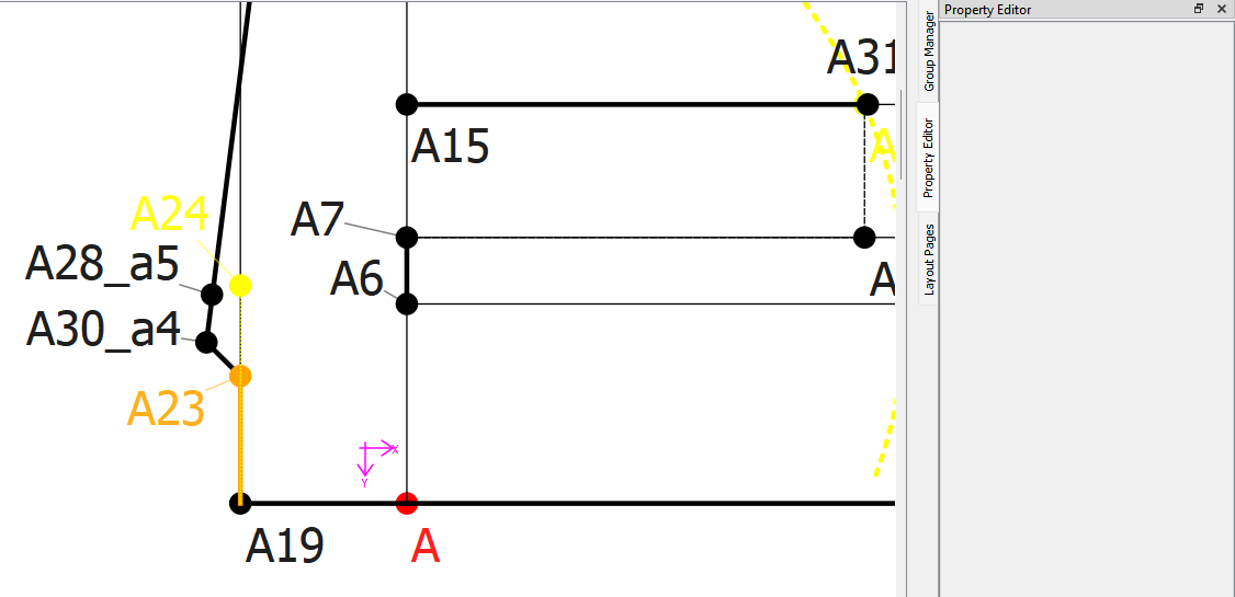

Lets look at this: It’s using the Intersect Line and Axis and the Intersect Curve and Axis.
Right now you can’t see the Lines or the Curve (arc)… until you click on the points. Like

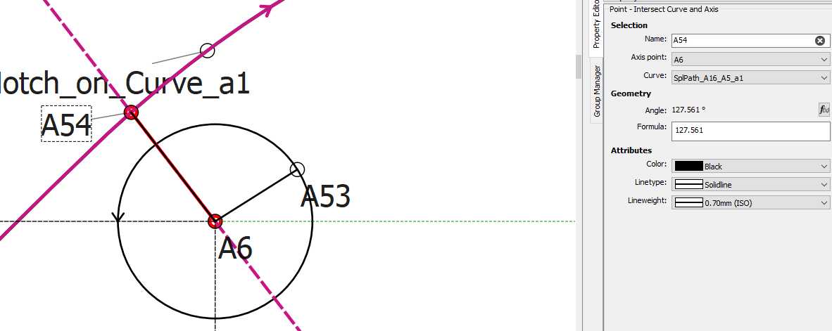

To make matters worse you can’t see the Arc to select it to edit, until you hover over it.

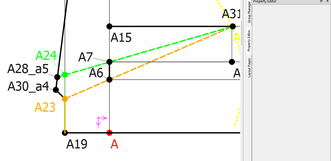

What I’m saying is that we can change the visualization so that those lines and arc persist after you’re done editng. So you would know where the arcs are like this:
or it can look like this without having to create the extra Lines.

Hmm… Yes, I think that will be useful if the Insect curve/arc and axis was being used, but it already does this, unless you change it to no line.
Duh… Nevermind on the arc. This is what I was looking at"

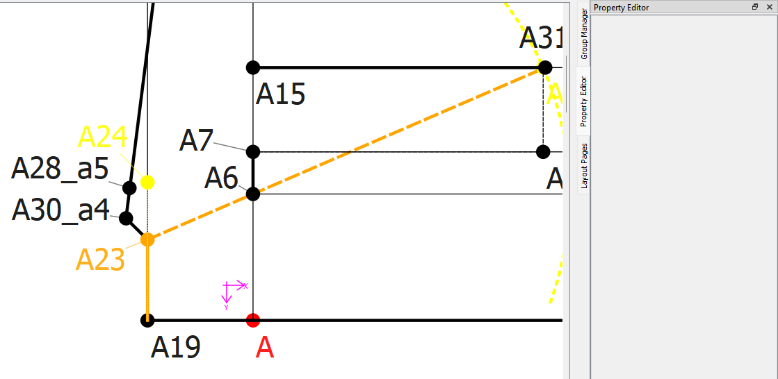

On the Intersect Line and Axis… this is what we have now for Point A23…
This is what I was thinking instead… where it also shows the axis line from A31 to A23.
And the same for A31 to A4…
Now when you goto insert the internal dart paths you can see it becomes more like tracing rather than connect the dots. Also it eliminates the need to draw the 4 extra (green) lines.
