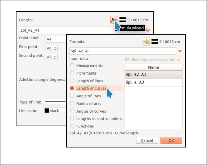

Hi @Irene!
Curve lengths can be found in the f(x) dialog:
