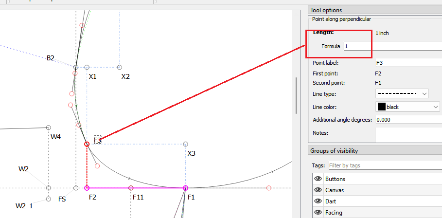

Here’s another example, where in one of my Jacket patterns the notch point is 1" above the breast line. In this case the Notch point is located BEFORE the curve is drawn… which is another option. You could locate A3 first, based on a proportional distance from CF, then 1 inch up. Then you create your armhole curve. For simplicty though the 3/4-1 above the breast line will put the notch point pretty close.
