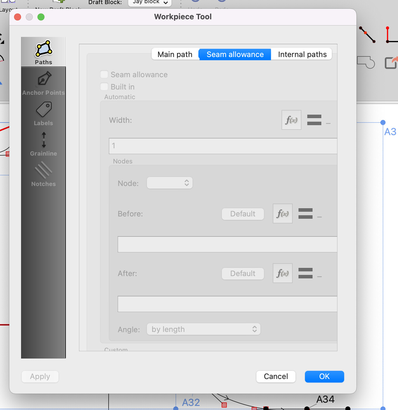

I can rotate now! But when i go to do seam allowances - the option is greyed out and i can’t find what I need to do differently to be able to have this active. Apologies for all my questions.

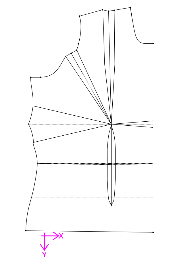

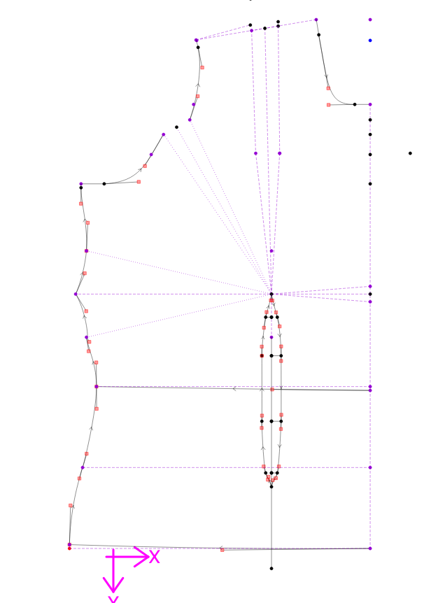

this evening was about inputting the front bodice! Much easier and got entirely through to pattern. I’ve used the dart tool for the shoulder dart (it might not be perfect, but i get the concept)
Question: what’s an easy way (or any way) to true the dart cutting lines to get the little opposite curves? (I’ve just eyeballed the bust dart) (I’m going to think on how to true the armhole curve overnight … :laughing: )
This is when you first trace it, yes? In order to use all the juicy Workpiece Tool options you must be in the Piece mode, not the Draft mode, (find it on the icon set Draft, Piece, Layout.)
Right click the piece you want to edit the properties of, & choose Properties from the dropdown for a fully active Workpiece Tool.

You can mirror just the curve on the one side of the line to the other side of the line.
:point_up: I’d use this tool.
Firstly, the 2 dart legs need to be exactly the same length. Then do a rotation to close the armhole dart only rotating the bottom curve so that the 2 edges meet, then you can adjust the 2nd handle of the original curve until the rotated one flows neatly into the upper curve - Normally, the 2nd handle on the lower curve can use the upper curve’s 1st handle direction +180 degrees (see formulas).
Further, you will need to figure out according to your patternmaking system. I’m not so very neat in this area :slight_smile:
