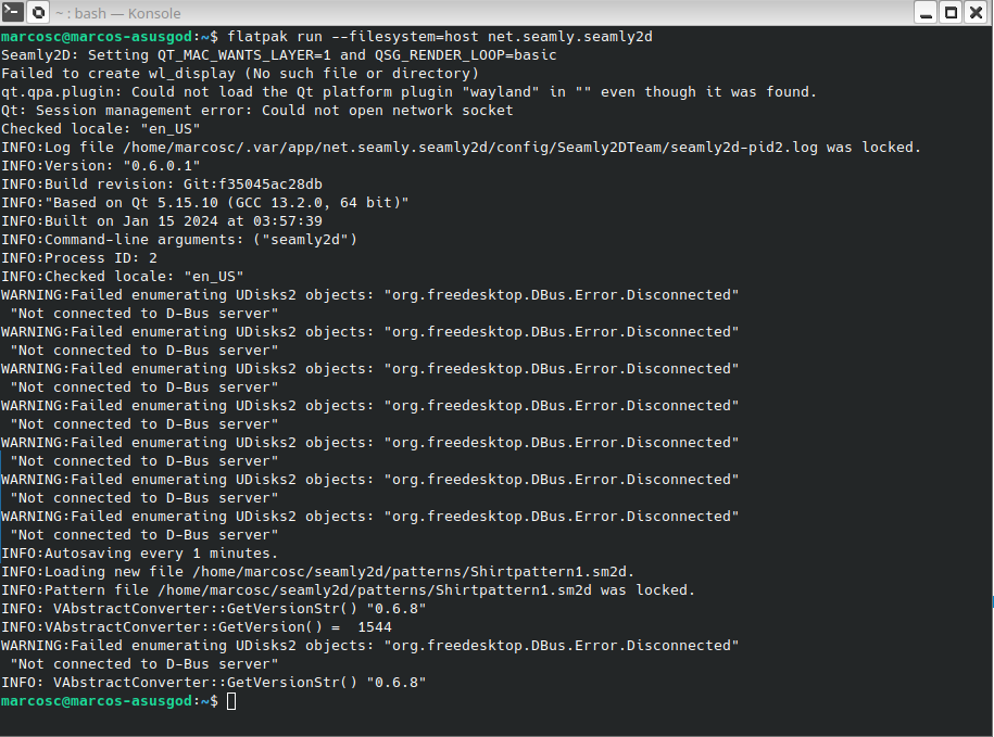

Hi again,
I didn’t have the /media problem but I ran the command anyway and since it runs from terminal I noticed more previously unseen error which may or may not help diagnose the problem.
Thank you for the updates, @ChisaoMusician the dbus errors can be ignored. I dont exactly know where they are coming from, but they are fine hidden in the command line, it was a temporary issue that they popped up in the GUI, but they have probably always been there hidden in the command line before that.
But good to know that Seamly is now running fine for you.
Yes the Appimage is a great work around and works perfectly, thanks.
Did you notice the things before the Dbus errors? It seems to come right before the “locked” error (which came back).
Particularly this with the “Failed to create wl.display” and “could not load the Qt platform plugin”:
Seamly2D: Setting QT_MAC_WANTS_LAYER=1 and QSG_RENDER_LOOP=basic Failed to create wl_display (No such file or directory) qt.qpa.plugin: Could not load the Qt platform plugin “wayland” in “” even though it was found. Qt: Session management error: Could not open network socket Checked locale: “en_US” INFO:Log file /home/marcosc/.var/app/net.seamly.seamly2d/config/Seamly2DTeam/seamly2d-pid2.log was locked.
