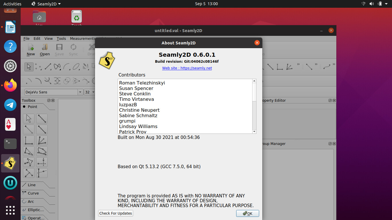

I just loaded the latest appimage from the github repository and the only issue I noticed immediately is that the main window can not be repositioned on the desktop and it does not have the tiny square at the top right of the window that would allow switch between full screen and resizable. It does not appear as full screen so will limit the working area available.
1 polubienie

Just loaded the 8_30 weekly build AppImage… and it filled my screen vertically, but left space horizontally to the right. Mine has the min / max “square” button.
Mind you I have used Ubuntu all of about 1/2 dozens times… but I figured out if you right mouse click on the Seamly2D pattern file in the tray a context menu pops up with Min, Max, Move and Resize options. I was able to resize the Seamly2D to full size. Closing and reopening the app is sized at the full size. I’m assuming this is due to the saving of the Window size and position in the Seamly2D settings INI file.

Well that’s interesting. Have you tried grabbing the lower right corner and dragging the size of the app window?
I had not, and when I just did it had no effect. I also tried a right click at the top of the window and got a (ubuntu specific?) menu that allowed me to move or resize the window.
Let me ask… is this something that is just showing up now with the latest Linux build?
I can’t say whether this just showed up because I this is my first ever attempt run any appimage version. I had a much older version from before you were doing the appimage and that one worked as expected.
You can see from my first screenshot that the little square box is not there. It is as you mentioned below the vertical space is filled. using the ubuntu menu I was able to stretch seamly2d fill the horizontal space.
This does not rise to the level of a problem, it is more a curiosity.
1 polubienie

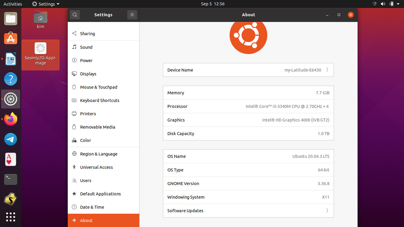

Odd. I don’t know how my settings may differ, (I’m sure they do,) but I’m also using Ubuntu 20.04.3 & have the resizing thing, & it’s full screen.
I have no idea if our settings differ. From my screenshot above, I hope you can see that I am using Ubuntu 20.04.03 and the Gnome desktop 3.36.8 under the X11 windowing system.
2 polubienia
