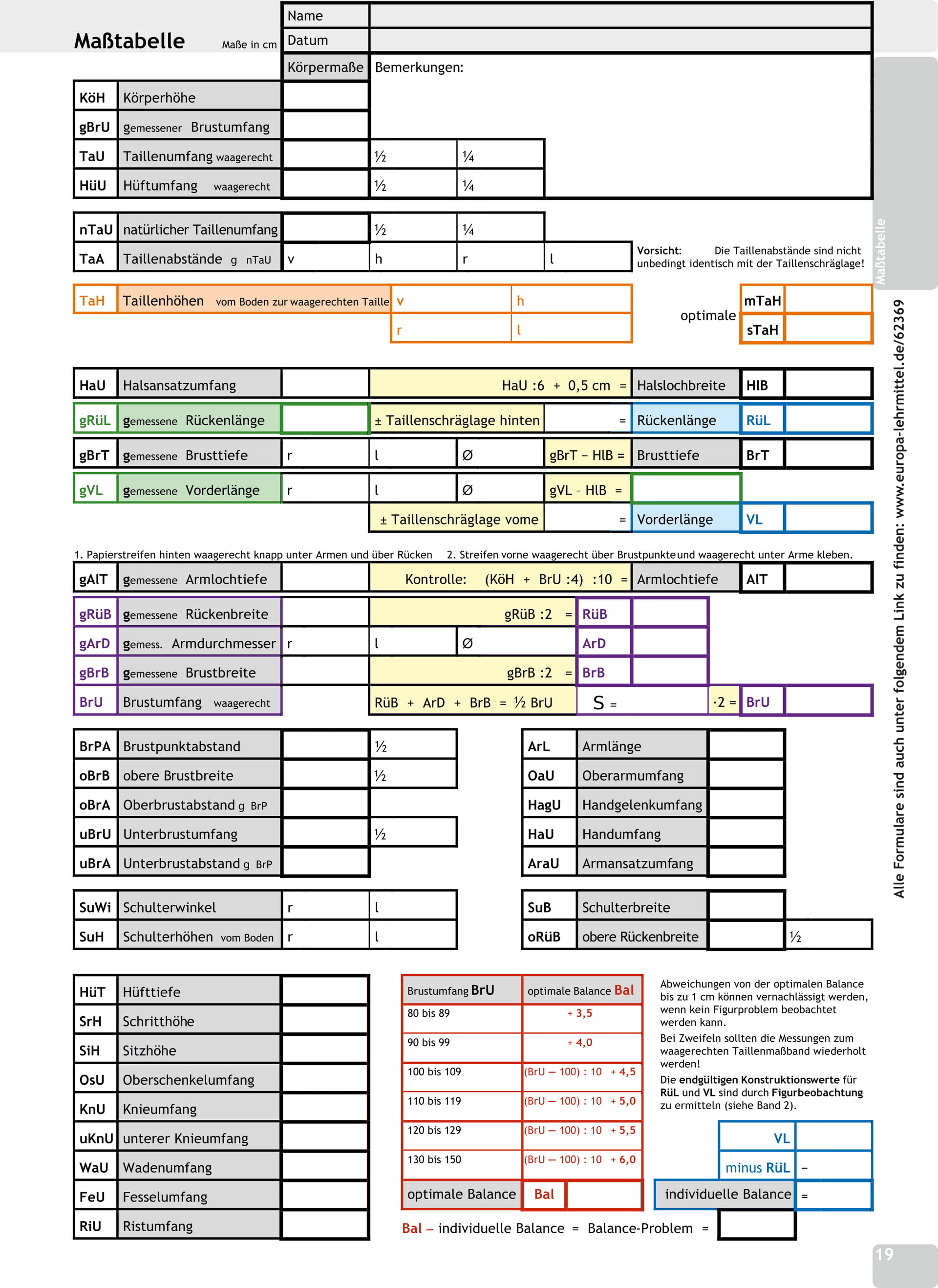

Here is the measurement form as a picture.
But you can also check out the forms and tables from the book download section:
