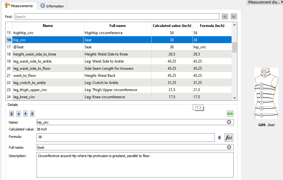

The full name of hip_circ is seat.

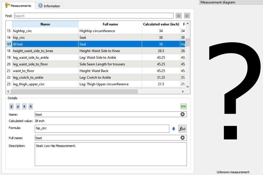

And yes… you could add a custom (alias) @Seat measurement… with a formula of hip_circ,
but if you notice there is no diagram and the name will not be translated. The way Qt handles translations there’s no way to translate variable text input by the user. Only hard coded text designated as translatable, and only if a translation for the chosen gui language is provided in a translation file will text be translated… or more specifically “replaced” on the fly.

The full name does not come up as seat for me, nor can I change the full name field. I may be missing something?
Yes, but I must give a value for the hip circumference so I can use the formula of hip_circ. I was hoping to leave all values at zero, but I could give them all a different value- maybe 10?
I am trying to make the measurement file specific to how it is listed in the book, but for instance, I cannot just add “half back” alone because the formula for across_back_b is needed first so you can add across_back_half_b Any way to get around this other than a custom measurement?

I had to take a second look today being more awake… and I’m still baffled. I screen capped the “hip_circ / seat” measurement the other night. from a build that was just compiled… and it now shows up as “hips / Hip circumference”. ??? Inexplicably the measurement file was not converted to a newer ver, - where apparently changes were made to some names… like hip_circ became hips… etc.
That being said… IMO it’s an oversight to remove the term “seat” as next to waist, rise and inseam, it’s the one of the most common terms when speaking of men’s pants. I think it’s a gender thing… where with men it’s “seat” and with women it’s “hips”.
hips
No… you are correct. You can’t edit the full name or the description. At least the fields should be greyed out to indicate you can’t edit them.
