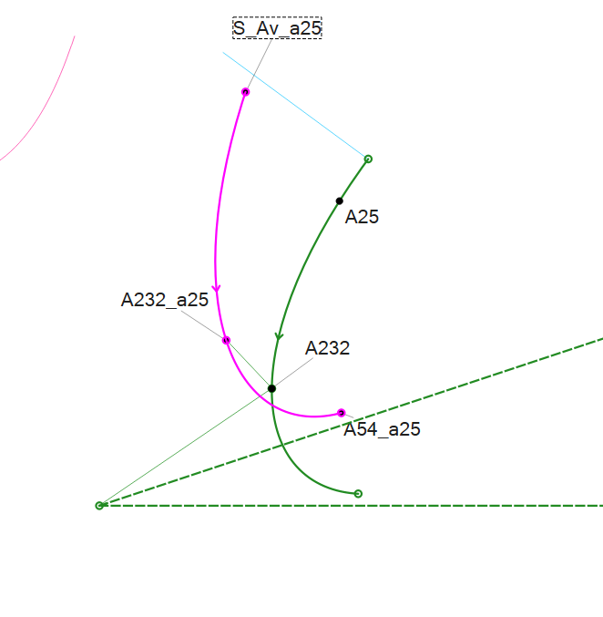

  • Creating an operation (move, rotate) automatically creates an operations group with suffix as the name: “_a25”

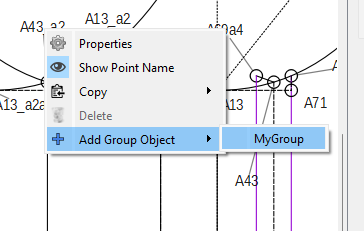

  • Right clicking on a member of the operations group displays ‘Remove Operations Object’ option under ‘Remove Group Object’.
  • Right clicking on a object that isn’t a member of any operations group display ‘Add Operations Group’ under ‘Add Group Object’.
