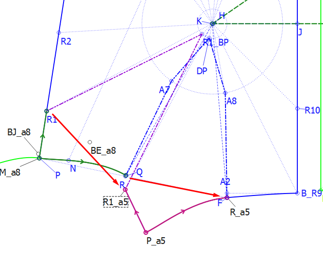

The bust point is always the rotation point on the front bodice - the same as when you are rotating the darts by hand.
Place a point at half the distance above where you would like the dart to be opened. Place a line from the BP to the new point.
Make sure that the existing dart has lines from the BP to each of the existing dart edges. (For easy formulas, it’s important that the lines are radiating outwards from the BP.)
Using the Rotate tool, select the BP and then, while holding down the CTRL key, all of the points and curves from the new point to the 1st dart side point of the dart (that you want to close) and hit enter.
In the formula box, enter the formula AngleLine_DartLeg2 - AngleLine_DartLeg1 (the formula will change depending on what these are named and which direction you’re working in). Hit OK.
The rotated points will have and extension of _a# appended to the rotated points and the DartLeg1 should be on top of DartLeg2.
Draw in the new lines.
Here’s an example of a dart moved to the side seam:

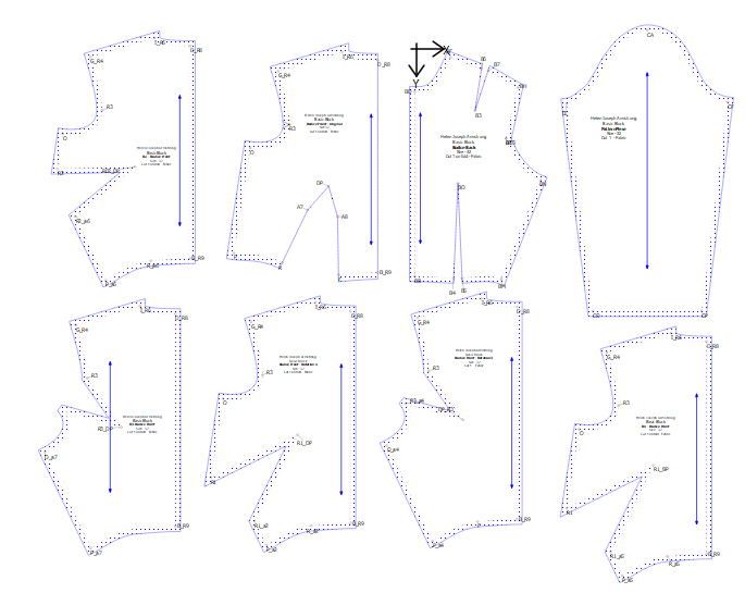

This is my collection of rotated darts on this pattern:
I haven’t done them all yet
