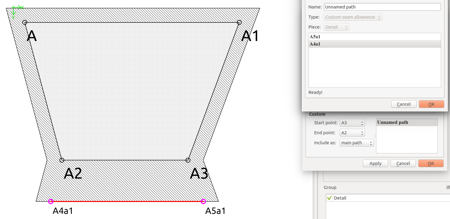

And finally i will show you actual custom seam allowance
On the first example a path included as main path and extend it.
On the second example you see case when you need only side pieces of seam allowance.
And on the last example path included as custom seam allowance. This type says Valentina that a path is actual seam allowance. It will include it as it is. This is useful in cases when automatic seam allowance can’t produce result you need. You of course can achieve the same result with include type ‘as main path’, but selecting one option is a lot more faster. Especially if you have a lot nodes in a path.
