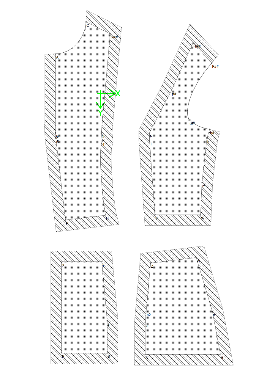

It’s working well on my moulage front. I eliminated seam allowance from the neck and armhole, but kept a generous one-inch elsewhere for fitting purposes.

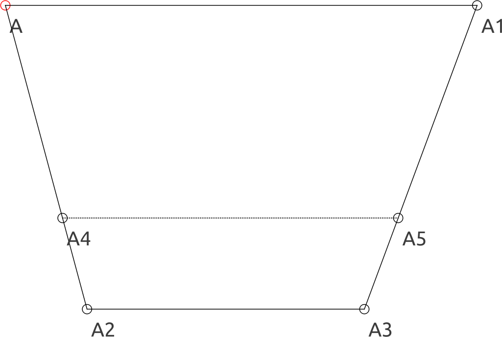

For example i want make a hem for this piece.
Basically i have only this
and current seam allowance doesn’t allow me create what i want. This is time for custom seam allowance.

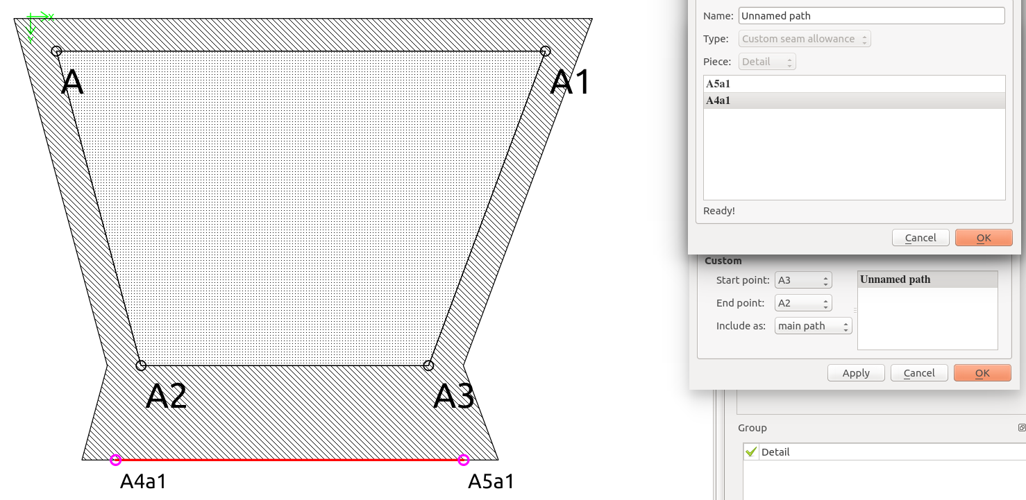

On the first example a path included as main path and extend it.

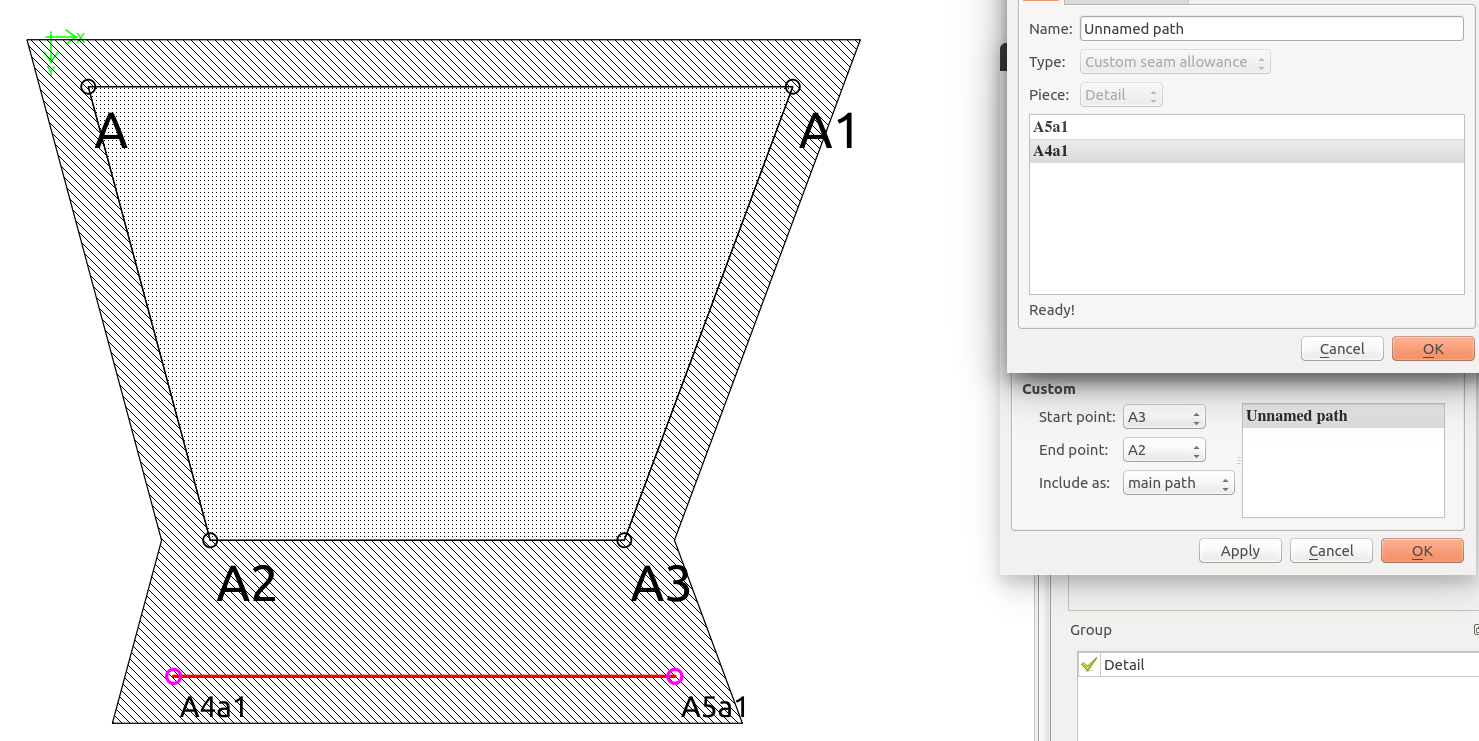

On the second example you see case when you need only side pieces of seam allowance.

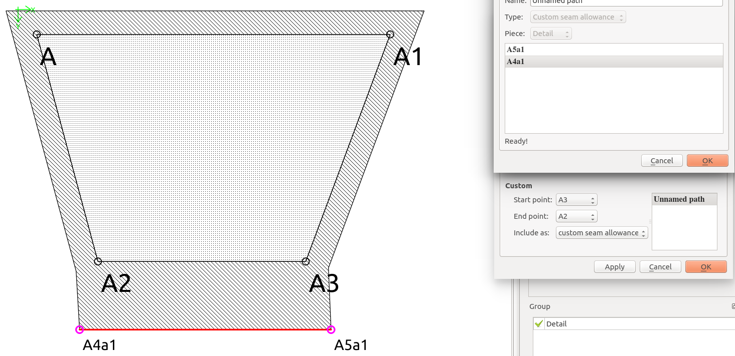

And on the last example path included as custom seam allowance. This type says Valentina that a path is actual seam allowance. It will include it as it is. This is useful in cases when automatic seam allowance can’t produce result you need. You of course can achieve the same result with include type ‘as main path’, but selecting one option is a lot more faster. Especially if you have a lot nodes in a path.
If your path selected as custom seam allowance you will not see the tab Seam allowance. I think this is logical, because in this case you are saying program that you describe seam allowance manually.
