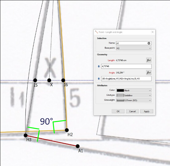

Referencing unaligned angles
I think it would be more accurate and easier to achieve if you first drew the hemline curves so that you could use the curve handle lengths and angles in the formulas.
If your hem curves were in place, you wouldn’t need to create extra points and, if the measurements change, the curves will resize very nicely later on:
