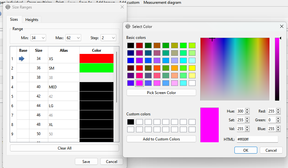

I’ve been working on cleaning up & integrating the BF’s code into SeamlyMe… here’s a WIP sneek peak to an updated “Size Ranges” dialog with the addition of a size “step”, a base size/height selector, and a size color column (for future nesting use) with the color selector:
I plan on scraping the size / heights "Grade Rules " dialogs and integrating the functionality directly into the main measurements table with color coded columns for each size to enter the increments in one table VS having to open a size & height rule dialog to set the increments for each measurement - which is tedius. For ex… the measurement file I’ve been testing with has 28 measurements… that means one would have to open a grade rule dialog 56 times to set all the increments across the ranges of sizes, heights, and measurements.
