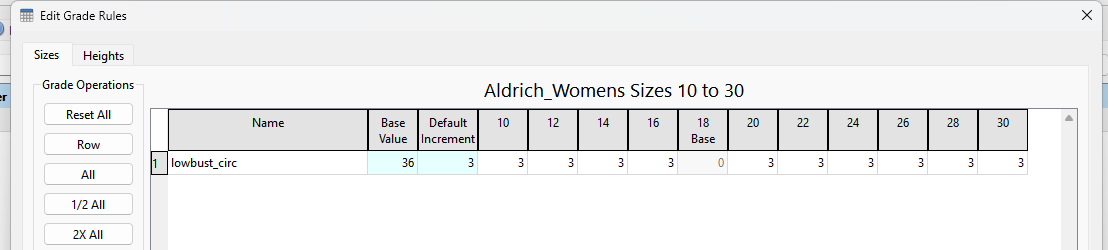

I also added a Title field to the schema… set in the Range dialog:
Displayed in the Grade Rules dialog:

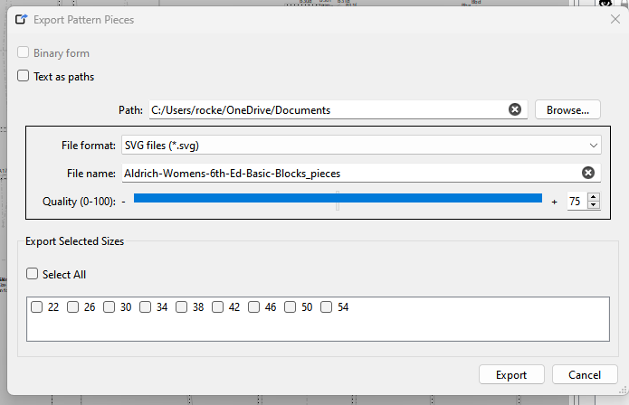

Export for multisize will now limit the availble size checkboxes to the range. I will probably switch the checkbox texts to use the aliases so it matches everything else.

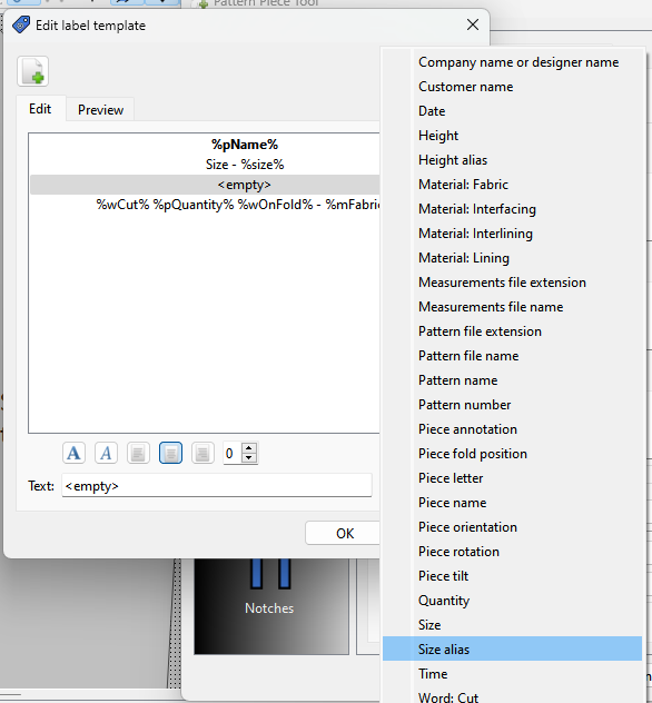

Moving over to piece mode… the label templates will have “size alias” and “height alias” placeholders.
