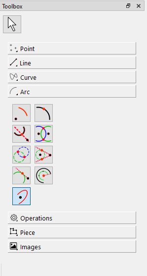

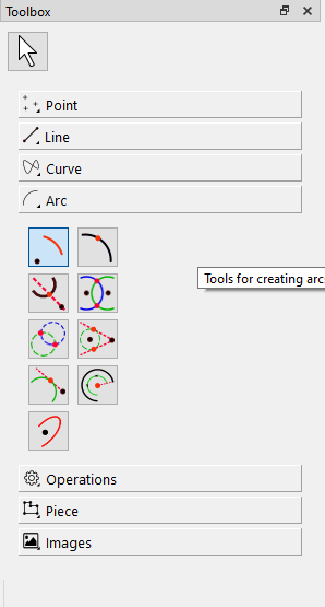

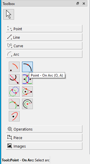

I seem to have discovered a minor issue - as graphically displayed below.
When selecting some (2) of the tools in ‘Toolbox’, the accompanying ‘Help Text’ is not displayed on the status bar on the lower left window frame. That is, this text flashes ‘On’ then vanishes after less than a second.

Help Text OK!
Help Text NOT OK!
Help Text NOT OK!
