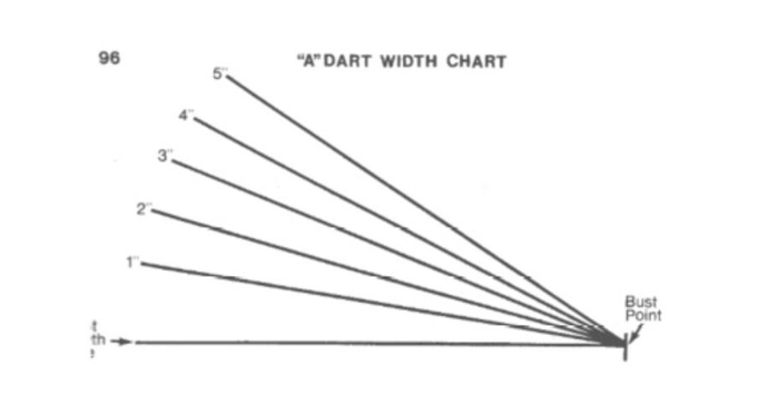

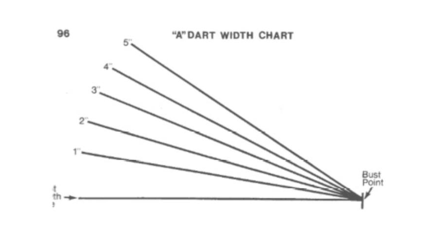

It is not a lookup table, it is a picture that you are encouraged to use (trace) when drafting a paper pattern. I want a pattern that is scalable to doll sizes as well as a wide range of human sizes. i have attached a picture of the table. I figured out that it uses a 3degree baseline and adds 6 degrees for each inch of difference between the highbust and bust. the problem with using an inch or using cm is that is not scalable. I will experiment some more with different sizes and come up with a formula based on the relative difference in the two measurements and not an absolute difference.
I had to use a physical protractor to figure out that the increment was 6 degrees. And I had to print one out to use it. I looked in 3 stores and was unable to find a plastic protractor like I once used. Computers are good until the EMP
@bamba my issue is determining the cup size for a pattern to fit a body outside the range where a one inch or 2.5 cm difference is the correct increment. For example, I want to create a pattern that will work on 1/4 scale dolls. I also have already tackled this problem when working with members of the chorus at the theater where I create costumes for women with a bust circumference over 65 inches (and a waist over 56 inches). Commercial patterns don’t work well for these women and patterns I have drafted with other software don’t work well either. I am sure that the issue is that the commonly used “one inch” or “2.5 cm” increment is not valid and that the cup size should actually be a ratio, not an absolute number
