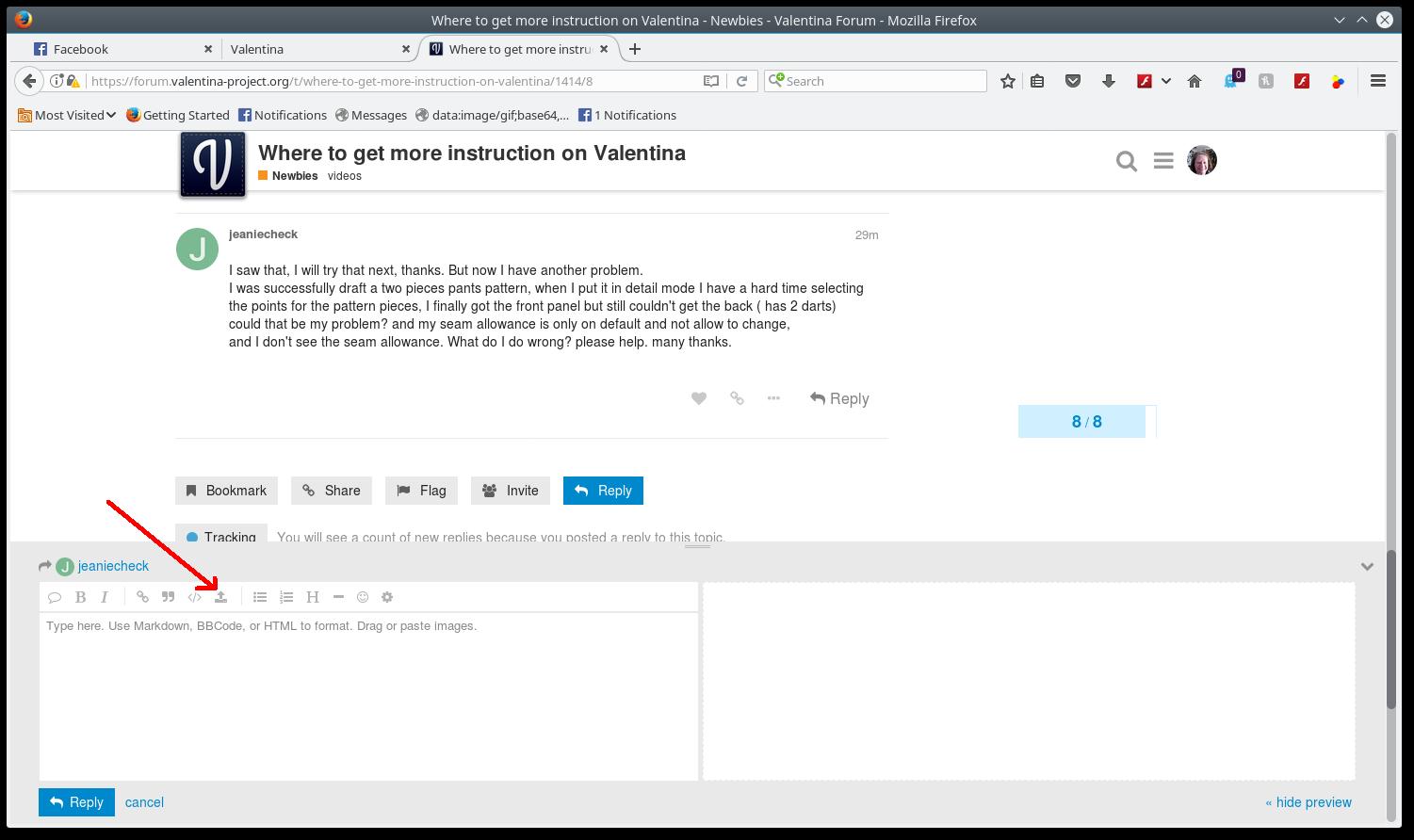

I do not have enough information to answer your question. Could you please post you pattern (.val) file and your measurement (.vit) fil. you can use the upload icon in this message window to locate those files on your machine. I will try to find what is wrong, and if I do not understand I will ask more questions or someone else on this forum may join in to help. This picture shows you where to find the upload icon.
