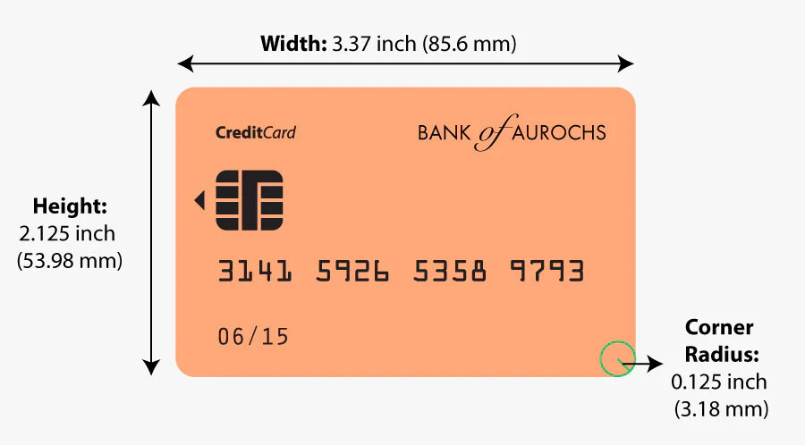

Another solution, more widely spread, is to use a credit card:
You create a rectangle in Seamly that has the dimensions of a credit card, and you superpose a credit card over your screen to adjust the zoom level. This way you don’t have to cut anything out of paper.

I having been looking at zoom 1:1 as part of the zoom features and thought the very same thing, it looks too small. Using Grace’s credit card approach you need to have a zoom of about 115% to get the drawn credit card size to match the actual size of a credit card.
