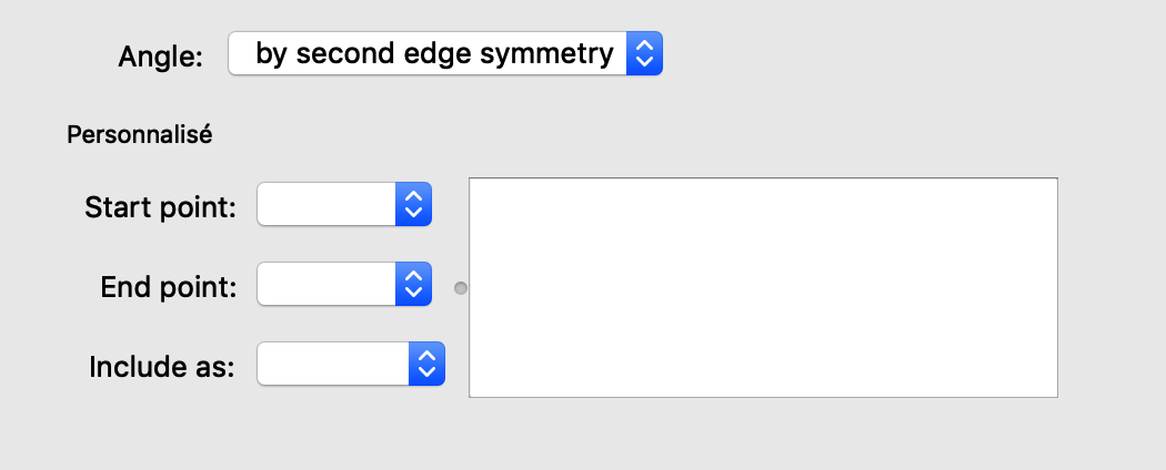

3- la fonction personnalisée il ne fonctionne pas !!! comment faut-il faire pour que cela fonctionne car je suppose que c’est là-dedans que je pourrais éventuellement créer des angles bien précis pour le réglage des coutures niveau des coins 3-the custom function it does not work !!! how does it work so that it works properly I guess it’s in there that I would like to be able to create precise angles for setting seams

Je voudrais pouvoir personnaliser les angles de mes coutures mais cela ne fonctionne pas quand j’active le bouton y’a rien qui se passe Y a-t-il une procédure.
I wish I could customize the angles of my seams but it does not work when I activate the button there is nothing happening Is there a procedure
Merci merci beaucoup Grace :grinning:
Hmmmm… yes… I must admit that those are the settings that I have avoided at all costs :frowning: It’s such that I can’t even get the custom to work. I see that you at least get the arrows to play around with.
I’m going to hope that someone else will come by that can help you. Sorry
Although… if you create your pattern with the seam allowance built in, that would mean that by clicking the ‘Built in’ box, it should draw the seam on the inside of the pattern lines. But that would mean that you need to change your whole pattern.
Nope. That doesn’t show any seam allowances :frowning:
