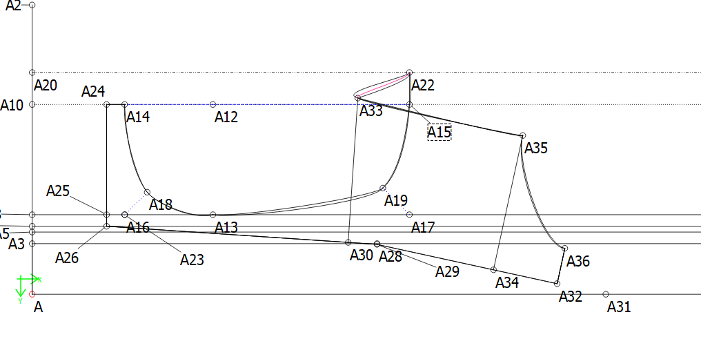

How would I do a 90 degree angle off a curve and flow off the curve?90%20degree%20angle top%20cup%20instruction

I’m thinking that you would like line B1 to B10 to be at 90 degrees of the angle of the curve B1 to B3. In this case, I’d enter the angle formula of B10 to be the angle of curve of the 1st handle of the curve B1 to B3 plus 90 degrees.
By ‘Flow off the curve’ I take it that you want the curve to move off line B1 to B10 and then to curve away. I’d enter the formula on the 1st handle be the same angle as the line B1 to B10 with a length of perhaps 1cm. This will extend the line and ease immediately into the curve to the right.

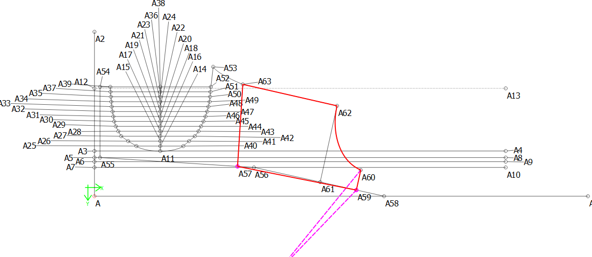

When grading i decided to try going out point A15. How do you keep the lines from going distorted and matching the cup lines to the cradle lines. Or will this not be possible?

Ok, I’ve had a quick look and the first thing that I see is that you have ‘hard-coded’ the measurements. It would be a lot quicker and easier in the long run, if you created a .vit (measurement) file using SeamlyMe. Then you could create one for the tutorial pattern so that you could follow the tutorials and then copy that .vit file by Save As and add your name or something. Edit the values to your own measurements.Then you can just change the measurements file to resize your pattern and all the points should move according to the measurements.
You may need to tweak the curves a bit, but the basic layout shouldn’t cause what has happened in your image above unless you have made a small error in the measurements.
As it is, you’ll need to edit or redo the pattern using references to your measurement file instead of exact measurements.

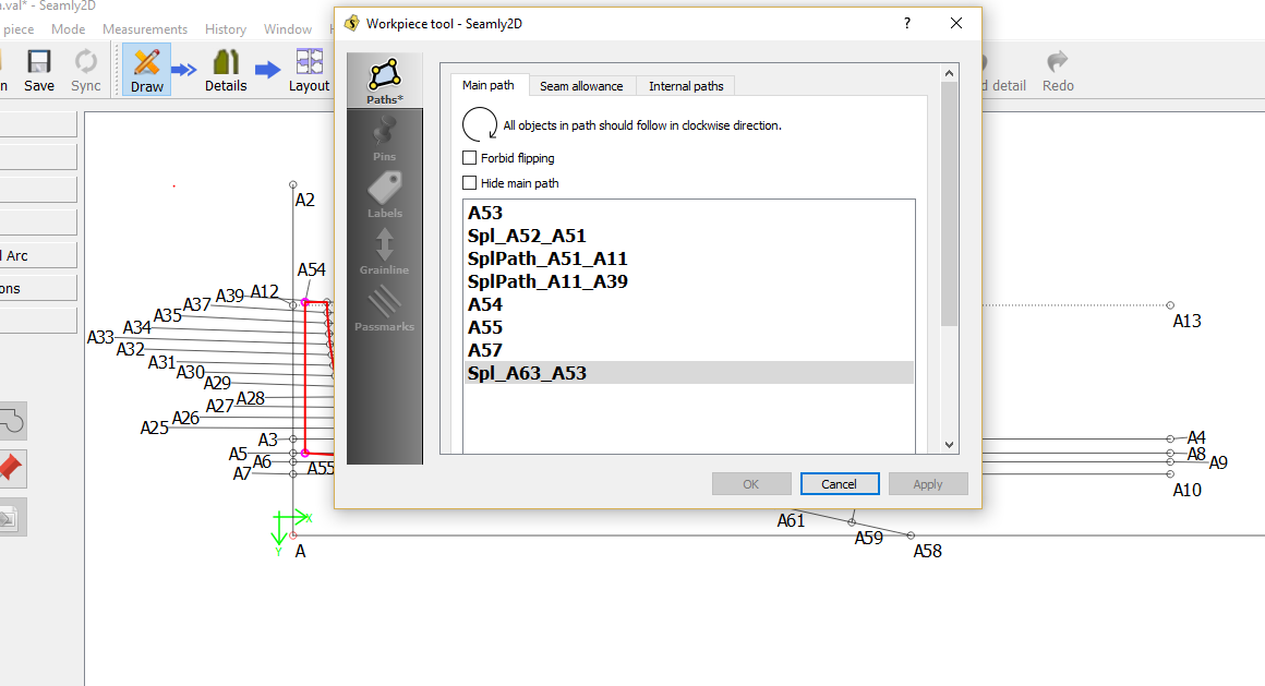

How do I group the lines for the cradle more efficiently?(workpiece tool) is there a way to update the software so that the workpiece tool does not have to go clockwise? There is an error, it won’t let me group

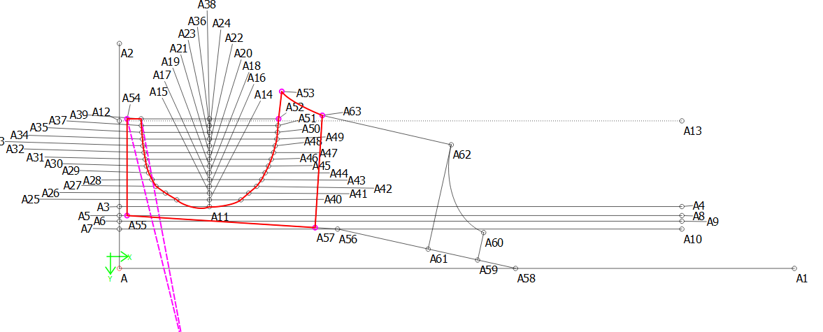

Actually, you can do this without requiring a change to the tool. I have created the workpiece that I think that you want in this file. 34B softbra.val (26.3 KB)
Here is a screenshot of the elements I used.Screenshot_20190601_102310
