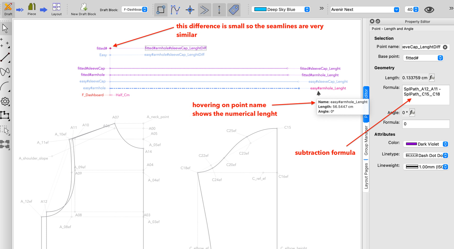

I wanted to share what I’m doing to check that the length of armscye and the length of the sleeve cap is compatible:
I create a empty block at letter F (it means it’s the 6th in order of creation and ensures all variable and points are available to it) and create in it a series of line referencing in the formulas the difference between the two curves (see screenshot)
I also created lines which just report the total length of those seamlines, to check against other patterns, for example.

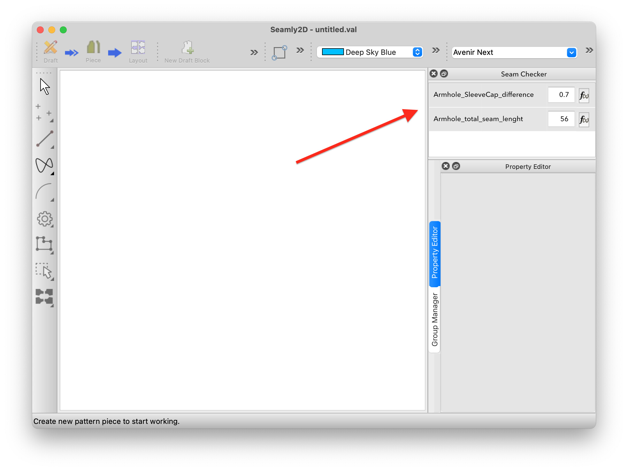

Could it be something like the Group manager, a panel used to check seams? How difficult would be to implement?
You do all calculation in background, without creating lines, and just show the final result as a number. Total seam length, difference between seam lengths etc.

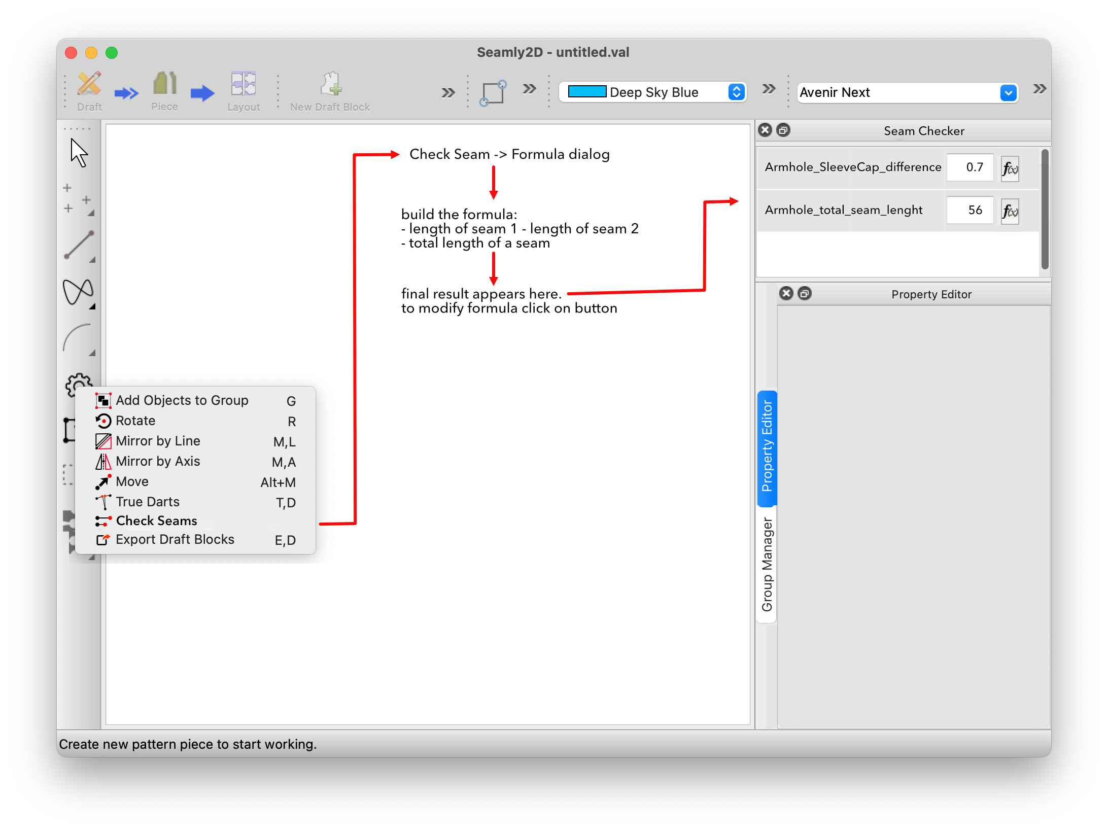

This would be the most elegant solution After clickint on the tool the standard dialog to build a formula would show up. You would then build whatever formula you want to check: a comparison between seam length: a difference. Total lenght of a seam: a curve or an addiction of lines or curves etc.
See updated mockup, the panel would scroll down, much like the Properties panel (panel? tool? sidebar? I don’t know the specific name) when it’s not tall enough.
Yes, but other instances of this UI are used to modify points and lenghts, This, in my opinion is something used to check them, non to design them. You would design the armhole in the block, keeping the panel open to rapidly check if other seams corresponds. So modifing the formula can be invoked when necessary with the button, but in this way you save a lot of vertical space, and as you say
it’s better to save space to show as many “checked seams” as possible.
