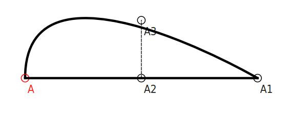

A small example to illustrate my point.
I created a point A1, a curve Spl_A_A1.
Subsequently I want to create the points A2 and A3 and use the length of A2_A3 as the weight of the spline.

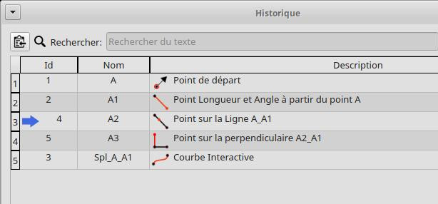

I place the pointer on A1
I create point A2
I move the pointer to A2
I create A3
I move the pointer back to the end of the history
The risk of crash is high when you have to add many points.

When did you last update your installation of Seamly? This has been implemented for a month now. You can find the latest releases on GitHub here: Releases · FashionFreedom/Seamly2D · GitHub
@Riton
Along with some bug fixes and other additions.
