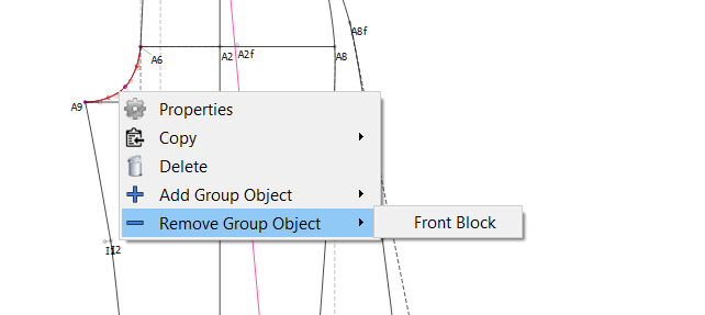

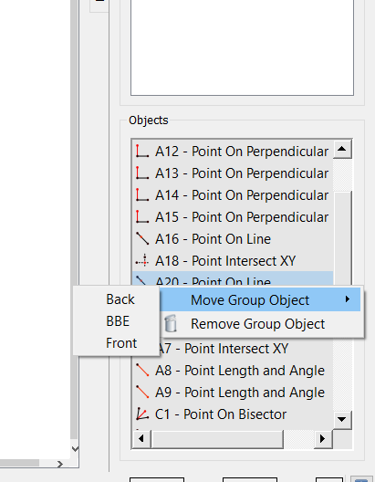

Do you think you could also add this option to move group object when you’ve actually selected it? A lot of times its hard for me to fish out the correct node/line from the big long list
If this is not possible, perhaps you could suggest a better way I can conduct my workflow?
Basically the reason I need it: I draft my base block, copy and paste the file, and then start making my adaptations like close dart, add ease, change side seam, pockets, etc.
So the issue is that in my base block I add my front to a group and my back to a group.
Now I am working on the front and some things have changed such as the side seam, hemline, and waistband, but others such as the inseam and crotch, etc have not been adapted.
So I’ve added my changes to a new group ‘Front New’ and then want to move my unchanged parts to it too and leave the others behind… if that makes sense?

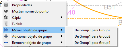

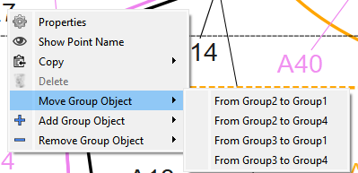

Well I spoke too soon… of course it’s never easy, and probably why I didnt add the move group option the point context menu. When you’re in the Group Manager and select an object you know what source group it’s in. When you select a point, the point can be in any number of groups… so we can’t just say move it to Group “x”.
Lets say there are 3 groups - Group1, Group2, and Group3, and Point A1 is currently in Group1. Well the context menu move items have to be:
Move from Group1 to Group2
Move from Group1 to Group3
Lets then say A1 is in Group1 and Group2… now the options have to be:
Move from Group2 to to Group1
Move from Group2 to to Group3.
As you can see the more groups, the more complex the context menu gets. :roll_eyes:
Solved: :slight_smile:
Oh wow! @Douglas , you’re a :star2:
This one took a little bit of thought… had to reconfigure the context menu to provide the source and the destination group id’s, unlike in the group Manager Object list where it just needed the destination group id’s.

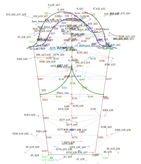

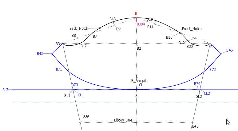

Here, you can see that I have my Basic sleeve in a group. This sleeve fits into the armhole of my bodice. If I want to print a pattern with this basic sleeve, all I have to do is to open the Eye on the group and I can select all the points without any distractions from other construction points. I can see the outlines very easily.
This is something that it will look like if I didn’t have things in different groups:

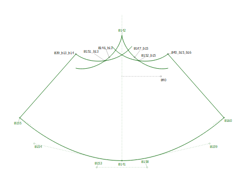

This is a short bell sleeve. Once again, you can see all the points that I need to draft the pattern piece:
As you can see, the sleeve cap section is actually shared between the basic sleeve and the bell sleeve, so I want it in 2 groups.

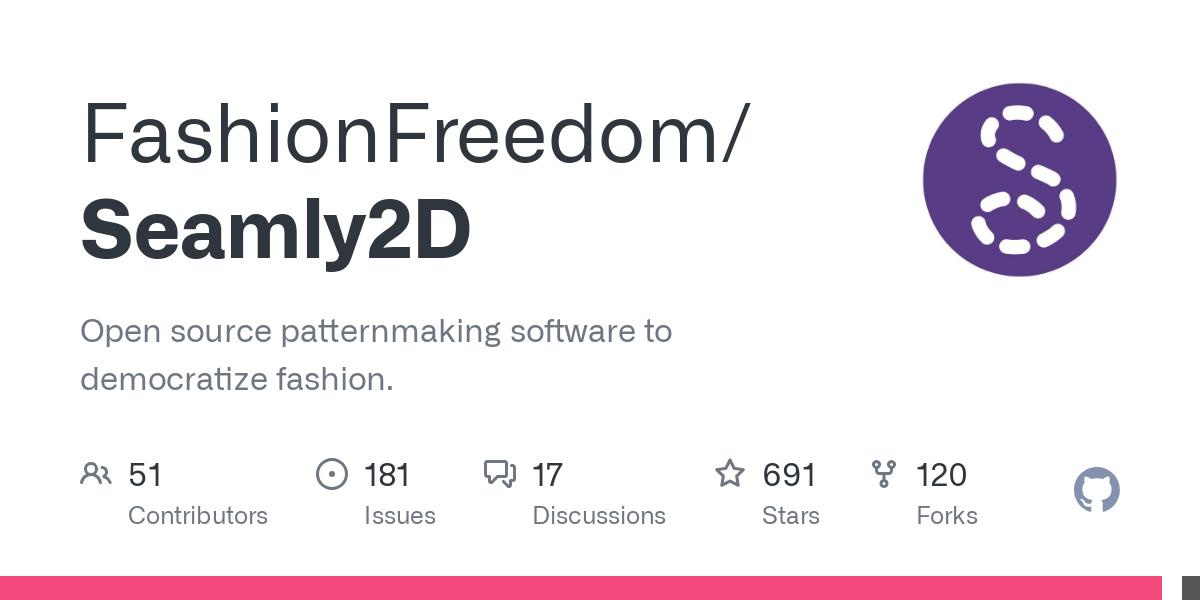

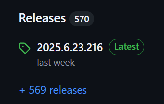

The “Download Latest” link at the top of the forums should give you links to latest release. If you want to stay on top of any new release - which happens every monday (late sunday night for me) - you can go directly to the Gihub page:
Scroll down and off to the right sidebar you will find the links to the latest release and any “pre-releases” - i.e. builds made during the week when a PR is merged.
Actually I wouldn’t mind it if more users downloaded pre-releases as they can act as beta testers where we might be able to catch bugs before the release comes out.

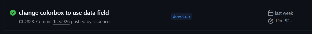

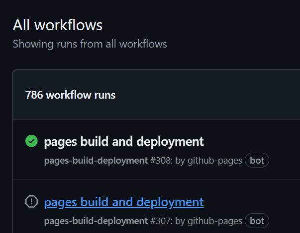

If you really want to be on the cutting edge you can check out builds in progress before they are merged as an artifact. Click the “Actions” tab on the toolbar:
Screenshot 2025-06-28 170900
Which brings up a list of all the workflow runs… That is everytime a PR (Pull Request) is made, Github will run a job and build all the os versions of the apps.
You can then select aand open a ci workflow such as the last PR I made:

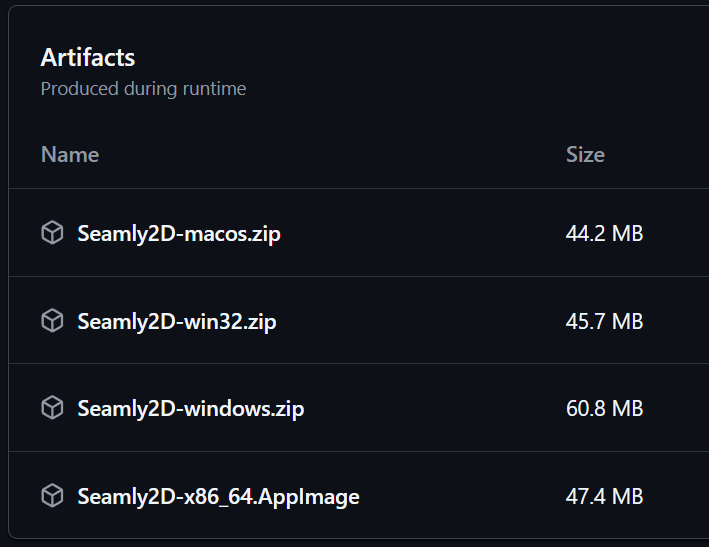

And then scrolling down you will find the artifact builds:
Ok Wow very nice and informative thanks
