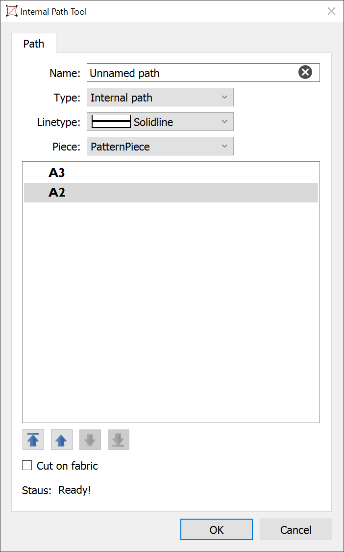

Add internal path tool
Hi, can someone explain the use of the checkbox: Cut on fabric?
I believe it’s a currently non-functional check, meant for when Seamly has a proper marker, so that it can be used with a computerized cutting machine.
But it possibly already has uses that way.
Thank you @Pneumarian . Any idea which machines are supposed to be supported? Are those only professional/expensive machines or are there some homeuse machines on the market?
I have a little Silhouette Cameo which cuts single pieces of fabric with a 12 inch width and up to 9m in length, but you need a sticky cutting mat to hold the fabric smooth and a special fabric blade. The larger flat-bed machines are quite pricey. You can get an idea in this video: https://www.youtube.com/watch?v=hoiiPHXIxZ8&ab_channel=EllenRUK
Do you use it to print your pattern? I would like not to glue sheets of paper to get my pattern
Not really. I’d assume any which communicate in hpgl. My plotter, which was running around $350 on Amazon this spring when it wasn’t on sale, 30" plottable width, does. I have not plotted a pattern with it yet, but I did do a continuous calendar for the upcoming school year. & that was from a linux computer, which is not supported by the software that comes with it, (Windows only,) but using inkcut I only needed to be observant & a little geeky to achieve success. I do wish I had done my first tests with a file which wasn’t my very symmetrical avatar, but at least I wasn’t plotting a mandala! :laughing:
It’s supposed to idicate whether you want internal paths included in the cut path (layout) when using a cutter to cut the pattern pieces. For example you probably don’t want placement lines (aka “internals” as per astm) for pockets cut in the fabric, where as there are times you want what are defined by astm as “cutouts” to be cut.
It should be noted the text used is legacy from the previous dev, and I would say we might want to reword it. Maybe something like “Include internal paths in cut path”.
I should also note that one can also set the color of the “internals”, and depending on the cutter, it will only cut certain colors in an svg, and ignore the rest. Enabling the cut on fabric will set the color to black in the layout - which is usually the color that gets cut.
